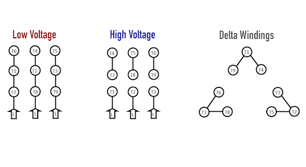

Delta Wound Motor Diagram
The use of the term Delta refers to the Greek letter resembling a triangle. The schematic arrangement of the Delta motor is this triangle pattern, except it’s broken on each side to allow user-customized connections for high or low voltage.
Three phase motor Delta wiring diagram
Figure 2. Schematic arrangement of low, high, and Delta motor windings.
The terminal connections and the internal arrangement of a typical nine-lead Delta winding motor.
As with any three-phase motor, those six windings (which appear as the straight lines on the diagram) are distributed around the perimeter of the motor to create a balanced rotation.
A previous article about Wye-wound motors described the need for lower resistance with lower voltage supplies. This is equally true in the Delta arrangement. In a short summary, if the voltage is lowered from 480 to 240 volts (half the voltage), the current must double in order to create equal horsepower. However, if the voltage has been cut in half, the resistance must be cut to one quarter of the previous amount in order to produce twice the current. This must be true in the case of both motors — high voltage wiring should have 4x the resistance of low voltage wiring.

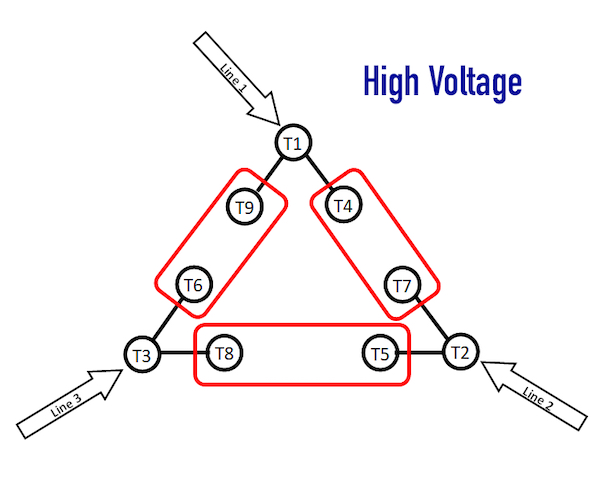

When the high voltage connections are made, this diagram shows the resulting connections.
Incidentally, the terminal connections are exactly the same for high voltage in both the Wye and Delta motor configurations!
In the Wye motor, high voltage resulted in a connection of the large Wye with coils in series. In contrast, inside a Delta motor, the high voltage results in a large Delta shape. However, the coils are not simply in series anymore. What results is a series-parallel combination circuit.
Imagine yourself being an electron, following the current path from Line 1 to Line 2. Two different current paths exist.
First, current may travel through T1-T4 then straight to T7-T2 directly. This equates to two identical windings in series.
Second, it may travel through the path T1-T9 then to T6-T3-T8 and finally to T5-T2. This creates the equivalent of four windings in series.
If two parallel paths exist, one having the resistance of two windings, the other with four windings, the result is the parallel combination of 2R || 4R which yields 4/3R, or 1.33 x the value of one winding.
Compare this to the value found in the high voltage scheme for a Wye motor. In a Wye motor, the value is four times the resistance of one winding alone. As you can imagine, this yields much more current (and therefore power output) in the Delta motor, assuming the input voltage and other parameters are equal.

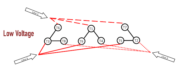

When the low voltage connections are made, this diagram shows the resulting connections.
The image above has been rearranged to simplify the situation as much as possible. Each line input is connected to one of the small Delta triangles inside the motor. This setup only requires three connections, so if you open up a motor casing and find only three-wire nuts, you have identified a low-voltage Delta motor.
In this scheme, imagine Line 1 to Line 2. There are three different possible current paths in this case, so we can list each option.
  1. T1-T4 through one winding.
  2. T7-T2 through one winding
  3. The parallel of T6-T3 and T1-T9 and then through the parallel of T3-T8 and T5-T2. This yields a series of two sets of parallel windings - the overall result is one winding equivalent.
When these three paths are placed in parallel with each other, the final resistance is equal to 1/3R or 0.33 x the value of one winding. As expected, this is exactly ¼ of the value of the resistance in the high-voltage configuration.
