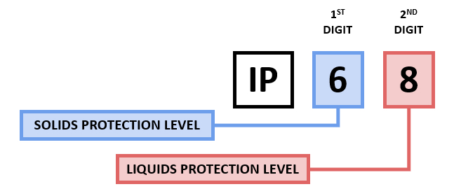

Unlike the NEMA Type enclosure ratings, which seem to use arbitrary numbers with random numeric assignments, the IP rating system is more systematic with a very defined structure. The IP ratings are primarily broken into two digits and in some occasions, an optional third letter or digit. The first number shown determines the level of protection against the invasion of solid objects into housing, with the lowest number offering no protection and the highest number offering the most amount of protection.
The second number determines the protection level against external liquids getting into the housing, and as with the first digit, a higher number indicates more protection.
IP (Ingress Protection) Rating Structure.
