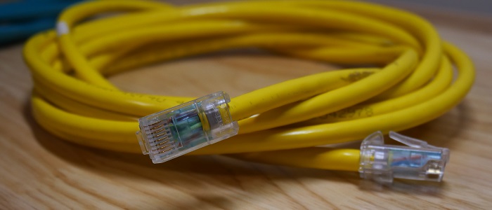

The Registered Jack, or RJ45, is a common physical interface for the connection of ethernet cables and is often used for large wired Ethernet networks. The RJ45 connector has eight connection pins and can be used for connecting devices to facilitate effective data communication.
Ethernet cable with RJ45 ends
Figure 1. A familiar RJ45 connector at the end of an Ethernet cable. Image provided by the Control.com engineering team
RJ45 Ethernet switch connections have long been the backbone of industrial networking infrastructure, providing reliable and versatile connectivity for various devices within a local area network (LAN). These connections utilize RJ45 connectors, which are standardized for Ethernet communication and compatible with twisted-pair copper cabling commonly used in industrial settings. RJ45 Ethernet ports offer simplicity and familiarity, allowing for easy integration with existing equipment and infrastructure.
With RJ45 connections, industrial Ethernet switches facilitate seamless communication between devices such as computers, PLCs, I/O and motion controllers, and actuators. This enables real-time data exchange and control for industrial automation systems.
Some RJ45 switch connections can usually support Power over Ethernet (PoE) technology, enabling the transmission of both data and power over the same Ethernet cable. This helps to simplify installation by reducing cable clutter and limiting expensive labor costs for installation.

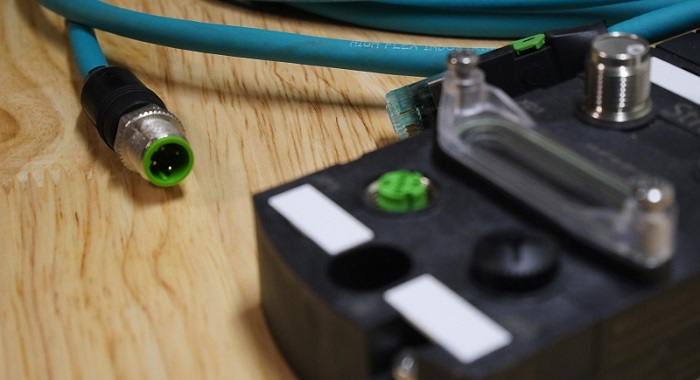

M12 Industrial Connector
For on-machine network solutions, regular connectors would not be appropriate. Not only are typical RJ45 and fiber connections fragile, they also allow tiny particles of dust and moisture to enter the switch. This may be just fine for control cabinets where you can protect the switch, but directly mounted on the machine demands something more robust.
Ethernet with both RJ45 and M12 connectors
Figure 3. An Ethernet cable with the familiar RJ45 at one end (center top) but a D-coded M12 at the other end (left). If you look carefully, you can see the missing pins on the RJ45 connector since the D-coded cables only have 4 conductors. Image provided by the Control.com engineering team
Threaded M12 connections, just like those found on many sensor and I/O modules, are used for these short-run, on-machine applications that transmit only data, providing an IP67 rating. A common application of these M12 Ethernet connectors is for IO-Link hubs and on-machine unmanaged switches. Some M12 Ethernet connectors have 4 pins (D-coded for Fast Ethernet), while others have 8 pins (X-coded for Gigabit speeds).

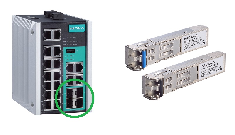

Small Form-Factor Pluggable (SFP)
SFP (Small Form-factor Pluggable) Ethernet connections consist of a small slot in a networking device capable of accepting an SFP module insert. Many modern networking devices have at least two SFP ports available to connect different switches via SFP modules and SFP-compatible cables.
SFP ports on Ethernet switches accommodate special transceivers, which are compact modules that enable the connection of fiber-optic cables, and sometimes copper cables. This modularity allows for easy adaptation to different networking requirements, whether it's extending network reach with fiber-optic connections or utilizing copper connections for shorter distances. SFP Ethernet connections provide flexibility for network administrators to mix and match transceivers based on their needs, without having to replace entire switches or buy multiple switches for each network type.
Moxa switch and SFP modules
Figure 4. A variety of SFP switch ports (circled in green) and modules. Image (modified) used courtesy of Moxa
Additionally, SFP transceivers support various data rates, ranging from 1 Gbps to 10 Gbps or higher, enabling high-speed data transmission for bandwidth-intensive applications. The hot-swappable nature of SFP transceivers allows for convenient maintenance and upgrades without disrupting network operations. SFP modules are often designed to be compatible with a wide range of networking equipment from different vendors. This helps to ensure usability and makes for easy integration into most existing network infrastructures.
Currently, there are variations of SFP that support higher speeds and fiber densities, such as SFP+ and XFP, and it is likely that as technology evolves, there will be new variations which will eventually make their way into the world of industrial automation.
