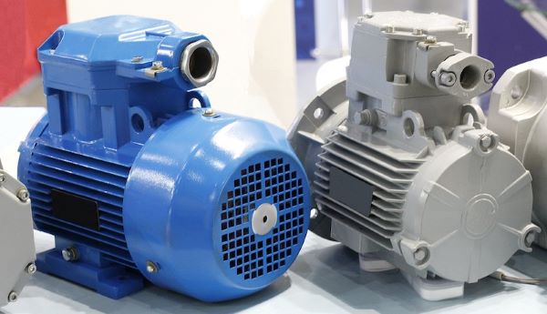

Industrial control systems are almost always supplied from a three-phase main voltage service. Because of the dangers associated with high voltage cabinets, this three-phase supply is often not well understood. Some basic knowledge of the systems can help to realize why certain devices exist, and why certain failures are encountered.
The main supply to nearly every industrial facility, and many small shops and even garages, is the common three-phase voltage supply. Many of the voltage levels can be extremely dangerous, so most of the critical components are secured inside cabinets with strict arc-flash controls. Since the concept is already somewhat confusing, the mystery of three-phase voltage seems even deeper when kept hidden behind enclosures.
Figure 1. Industrial motors utilize three-phase voltage.
Regardless, it is critical to understand these systems since they drive nearly every industrial motor, and smaller branch circuits feed every one-phase receptacle and lighting system.

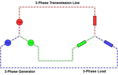

What does 3-Phase Even Mean?
No matter the system, either DC or AC, voltage is simply the potential energy between two charged points in a circuit. In a supply, this is the potential to drive energy between the + and - terminals, and in a load device, it’s the required energy to drive current between the + and - terminals.
In a DC system, the voltage is fixed at a constant, direct current level. However, in AC, the alternation is the rapid cycling change of voltage. Since it’s a cycle, the term ‘phase’ is used to refer to the line wire which is constantly changing with respect to the Neutral wire.
In either one- or three-phase AC systems, the energy difference will drive current from line to neutral or from neutral to line, switching 60 times every second (60 Hz, sometimes 50 Hz). In a three-phase system, there are three line wires, and only one neutral. Every line (L) will be alternately pushing and pulling current to and from the neutral (N), but not all at the same time.
Each L voltage is timed exactly ⅓ of a full cycle delayed from the L before it, which is referred to as a “phase difference” of exactly 120°. While one L may be trying to drive current toward the N, the other two L wires may be driving in the opposite direction. The main takeaway of this fact is that there will always be a (non-zero) voltage from at least two wires at any given time, and there will always be at least one voltage forward and one reverse.
3-phase transmission line
Figure 4. An animation of three-phase electric power flow. Image courtesy of Bill C. [CC BY-SA 3.0]
In contrast to this system, a single-phase voltage always has a zero-volt point twice per cycle. This leads to an unbalanced on-off-on-off driving of motors. Another disadvantage is that depending on when the motor is ‘switched on’, it may begin driving in either direction unless a phase delay is artificially inserted. Three-phase has this delay provided naturally. Excellent for motors.
