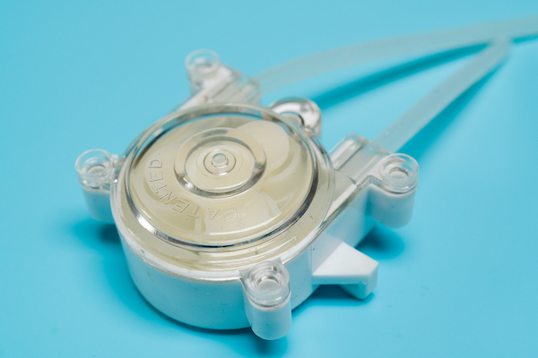

peristaltic pump
Figure 1. A peristaltic pump.

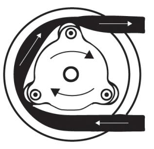

Peristaltic pumps are positive displacement pumps that insulate the fluid dispensed with the pump mechanism and external environment. The fluid passes through a flexible tube within the pump and it is pushed by a roller moving the fluid forward as shown in the image above. The shoes of the roller pinch the tube and move the fluid in the direction of rotation of the roller. Peristaltic pumps are also called roller pumps. In the schematic of a peristaltic pump given below, the roller has three shoes, moving the fluid in a clockwise direction.
peristaltic pump diagram
Figure 2. A simplified diagram of a peristaltic pump. Image courtesy of PMD.
It is obvious from the schematics that peristaltic pumps cannot deliver a smooth continuous flow of fluid. The fluid is dispensed in pulses. The amount of fluid that is dispensed in one pulse is equal to the volume between the two pinched portions of the tube, i.e the volume of the tube between two shoes of the roller.
Peristaltic pumps are used for high-precision fluid dispensing, where the liquid to be dispensed is in the microliter range and the tolerances are in the nanoliter range. Peristaltic pumps can reliably deliver such a high degree of accuracy and precision. The resolution of the pump is dependent on the number of shoes (the distance between them) on a roller. The higher number of shoes (less distance between shoes), the higher the resolution.

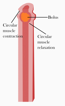

The peristaltic pump is inspired by mechanisms involved in the metabolic process that happens in the human body, especially the digestive tract. The mechanism is called peristalsis. As per Britannica encyclopedia, “Peristalsis, involuntary movements of the longitudinal and circular muscles, primarily in the digestive tract but occasionally in other hollow tubes of the body, that occur in progressive wavelike contractions.”
When food travels from mouth to stomach through the esophagus, it would have slid in a free fall to the stomach. But with the peristalsis movement in which the muscle contracts and expands to move the food in a regulated manner. It is also this same mechanism that allows for the regulated intake of air by lungs, movement in the small intestine, dispensing of fluids like bile in the body, and reproductive organs. These mechanisms are the inspiration for peristaltic pumps.
peristalsis in action
Figure 3. A simplified look at peristalsis in the esophagus. Animation courtesy of Auawise. [CC BY-SA 4.0]

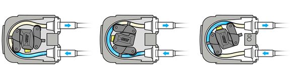

In pumps, the flexible tube is contracted by the shoe attached to the roller and the fluid is pushed forward through the tube by the roller in the same direction as the rotation of the motor to which the roller is attached. According to the movement characteristic required, a servomotor or stepper motor can be used to drive the roller. The rollers can also be changed to different designs according to the desired flow characteristics.
peristaltic pump process
Figure 4. How a peristaltic pump works. Image courtesy of Watson Marlow.
The flexible tube in the pump can be made of PVC (polyvinyl chloride), fluoropolymer, or silicone rubber. The main concern is the contamination that can be caused to the dispensed fluid. The choice of material should be such that the fluid and the tube should be inert to each other. Due to constant contraction, expansion, and pinching by roller shoes the tubes need to be regularly changed.
