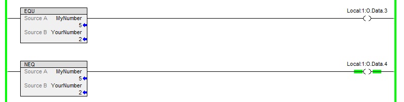

Using the EQU and NEQ (Equal, Not Equal) Instructions
Equal or Not Equal. These are the most self-explanatory comparisons out there. For the EQU instruction, if Source A is equal to Source B, the output is activated for the rung. The NEQ instruction is exactly the opposite. If the two are not equal, the output is activated for the rung. If you have extra permissive instructions in the rung, then those must be true in order to make your output fire. My rungs in Figure 1 contain only the comparisons.
EQU and NEW comparison commands
Figure 1. EQU and NEQ are opposite of one another. When values being compared are equal, the EQU goes true. When values being compared are not equal, the NEQ goes true. All images are provided by the author.
You might notice that my numbers are tags. The tags I am using are DINTs. If you were to compare a variable tag to a static number, then instruction would adapt to accept whatever type of number you plug in. If you put a decimal number in, the instruction will adapt to allow the REAL to be used. It can even compare a DINT to REAL even though the data types are different.

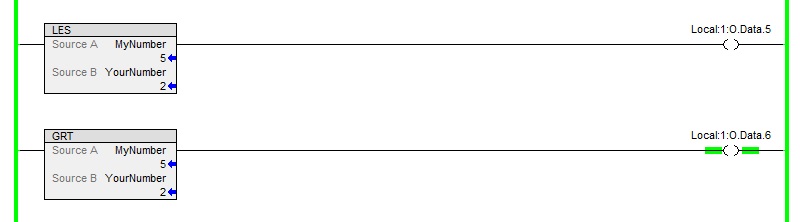

Using the LES and GRT (Less-Than, Greater-Than) Instructions
Moving on to more of the simple instructions—the LES and GRT instructions. For the LES, if Source A is less than Source B, the output will go true. For the GRT instruction, Source A must be greater than Source B. Don’t get your comparison direction confused though. Take a look at Figure 2 to see how these function. As with the EQU and NEQ, the instructions will adapt to any numeric data type you feed them and compare accordingly.
LES and GRT comparison commands
Figure 2. LES and GRT comparison commands: In LES, when Source A is less than Source B, the output goes true. In GRT, when Source A is greater than Source B, the output goes true.

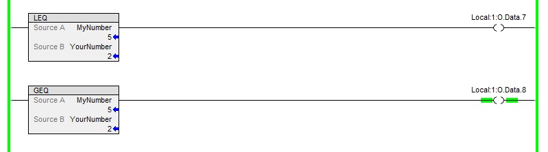

Using the LEQ and GEQ (Less-Than/Equal, Greater-Than/Equal) Instructions
Here is the last set of straightforward instructions. LEQ and GEQ combine the previous instructions. For the LEQ, if Source A is less than or equal to Source B, the output goes true. For GEQ, if Source A is greater than or equal to Source B, the output will go true. Data type info still applies here as well. It’ll work with whatever numerics you give it.
LEQ and GEQ comparison commands
Figure 3. LEQ and GEQ comparison commands: In LEQ, when Source A is less than or equal to Source B, the output goes true. In GEQ, when Source A is greater than or equal to Source B, the output goes true.

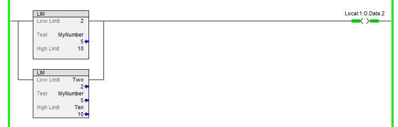

Using the LIM (Limit) Instruction
Now we’re starting to get to something a little bit more fun. I’ve thrown two limit instructions below. A LIM instruction checks to see if the test tag is between the values of the ‘low limit’ and ‘high limit.’ If it’s between the limits, it goes true. I added the first instruction so you can visualize a test against two static limits. The second instruction uses a test against two variables. Two is a DINT tag that can be any whole number that will fit. Ten is another DINT tag. These variables can be useful if you have to test a number against dynamic parameters.
You might see variables used in a batching program. If Batch A is running, you might see a certain set of variables. When Batch B is started up, the new variables from the recipe manager drop in, and the new sortation can begin.
A LIM comparison instruction
Figure 4. A LIM instruction checks to see If the test tag is between the values of the ‘low limit’ and ‘high limit’ of two static limits; if so, the output goes true.

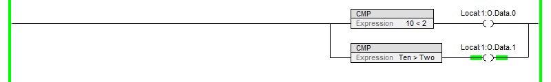

Using the CMP (Compare) Instruction
The CMP instruction is the most dynamic of everything we’ve looked at so far. It can be as simple or complex as you make it. I have examples in Figure 5 of some basic comparisons, but there are far more complex things that they can do. For all the different operators, you can use Studio 5000’s help file and search for ‘valid operators.’ You will find the list—there are dozens of operators. You can make formulas using absolute values, multiplication, division, logarithms, etc.
As with everything else so far, you can use tags or constants as needed and the program adjusts for data types robustly.
CMP comparison command
Figure 5. CMP is a dynamic instruction that can be used with dozens of operators in both basic and complex comparisons.
