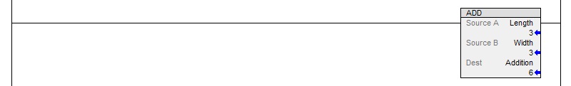

Using the ADD (Addition) Instruction in Studio 5000
When using the basic ADD instruction, there isn’t much to really keep track of. We add two numbers together and place the sum in the destination. In the logic of Figure 1, I add Length to Width and place the sum in the Addition tag.
ADD Instruction
Figure 1. Implementing the addition (ADD) instruction in Studio 5000. All images used courtesy of the author
It is important to note that you can take one of these tags, add a number to it, and then place the original tag in the destination. This will allow you to overwrite the old value with the new value. This is especially important for keeping running tallies. For example:

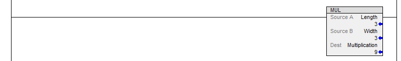

Using the MUL (Multiplication) Instruction in Studio 5000
Studio 5000 keeps up the simplicity and uniformity with the MUL instruction. Easy enough, throw your numbers in and the instruction takes care of the rest—dropping the result in the Destination tag.
MUL Instruction
Figure 4. Implementing the multiplication (MUL) instruction in Studio 5000.

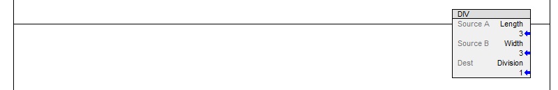

Using the DIV (Division) Instruction in Studio 5000
Much like the subtraction instruction, you have to make sure your tags are in the right order for the DIV instruction. Source A is always divided by Source B and dropped into the result. Don’t get it backward or you’ll be in trouble.
Also, keep in mind that loss of accuracy is likely during a division operation since the answer is likely to be a decimal or fraction, even if Source A and B are whole numbers. Be sure to account for this loss of accuracy or consider using REAL data types in the Destination tag.
DIV Instruction
Figure 5. Implementing the division (DIV) instruction in Studio 5000.

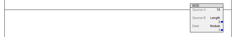

Using the MOD (Modulo) Instruction in Studio 5000
Now let’s get into something a bit rarer! I, personally, have never used this instruction in a real program. The module function returns only the remainder when given a division problem.
In the logic below, you can see I divided 10 by 3. We know that 3 times 3 is 9 and the remainder is 1 if we are not using decimal places. This means the Modulo function will give us a 1 in the Destination tag. If we plug in 25 divided by 5, our Modulo would spit out a 0. Similarly, 31 modulo 7 is 3.
MOD Instruction
Figure 8. Implementing the modulo (MOD) instruction in Studio 5000.

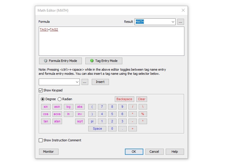

To write a formula, double-click the instruction and it will bring up the Math Editor Window shown in Figure 11.
Math Editor
Figure 11. Math editor window in Productivity Suite.
As you can see, this acts more like a fully functioning calculator than a logic instruction. Everything is right at your fingertips. This math system includes logarithmic functions along with basics like addition and subtraction.
As with other things I have seen in the Productivity Suite, they do a good job of putting everything right up front for you. While this may be overwhelming for some people, it does a good job of making it available.
One thing to keep in mind is using the Tag Entry and Formula Entry. To enter your formula, you have to be in formula mode, then switch to tag mode to enter a tag name, then back to formula mode to finish the formula.
