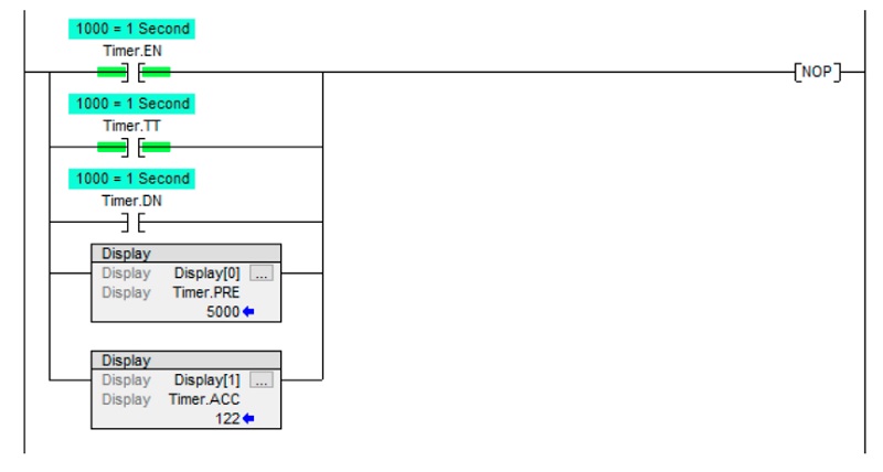

As shown in Figure 1 below, the TIMER Data Type consists of five individual tags:
  • Enable BOOL (EN)
  • Timer Timing BOOL (TT)
  • Done BOOL (DN)
  • Preset DINT (PRE)
  • Accumulated DINT (ACC)
PLC Timer Tags
Figure 1. Tags contained within a ‘TIMER’ data type. All images courtesy of the author.
The Enable bit is True whenever the timer instruction is active, no matter how much time has elapsed. The Timer Timing bit is True when the timer is actively performing the timing operation. The Done bit goes TRUE when the timer has counted up to reach its Preset. The Preset is an input that allows the user to ‘set the timer’ for how long it lasts before completion. Finally, the Accumulated number shows the user how high it is in its current count.

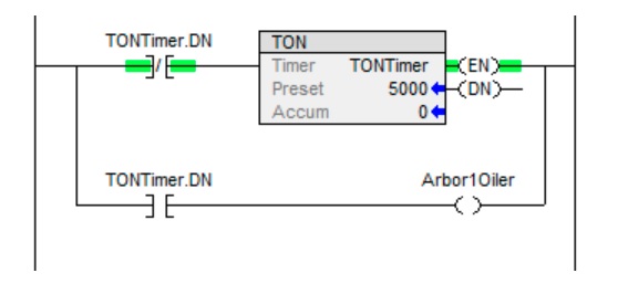

The TON instruction is likely to be the one you will see the most. Its function is very simple. When the rung powering this timer is True, it begins counting up in millisecond intervals.
TON Example
Figure 2. TON instruction example
In the logic in Figure 2, you can see the TON instruction. Because I am using a Normally Closed (also called Examine If Open or XIO) Instruction in front of it, the timer begins counting up whenever the timer is NOT Done. When it counts up all the way up to 5 seconds, the timer enables the Done bit. On the very next scan of the program, since the timer is activated when the timer is NOT done, the PLC will immediately shut off the timer, reset it, and trigger the Arbor1Oiler system for one brief pulse. On the next scan, the Done bit will be switched off and the timer begins to count up to 5000 again. In other logic, the timer may be turned on by a temperature sensor or a push button. The trigger and reset are determined by how your program needs to function.
The TON instruction begins counting up when the rung is True, triggers the Done bit when the Preset is reached, and resets the count to zero when the rung goes False.

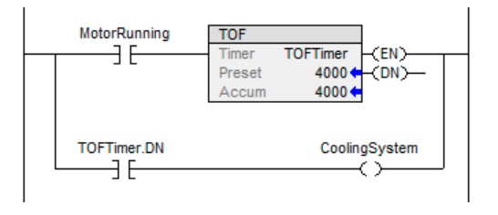

The Timer-Off-Delay instruction is not as common as the On-Delay, but is applicable in many special cases where a load must be kept running for a short time after a machine turns off. Surprisingly, and often confusingly, this timer’s Done bit becomes True as soon as the rung goes True and it holds the Done bit until the timer has finished counting. The timer begins counting when its rung goes False.
This is especially useful when you need to maintain something running for a while after an event takes place. An example of this might be if a motor shuts off, but you need to hold its cooling system on for 4 seconds after it shuts down.
TOF Example
Figure 3. TOF instruction example.
In the logic in Figure 3, you can see the TOF instruction. When MotorRunning goes True, the Done bit enables and turns on CoolingSystem. When MotorRunning goes False, the Done bit stays True until 4000 more milliseconds have passed with the cooling system running. That’s when the Done bit drops out and CoolingSystem turns off.
In review, the TOF instruction sets its Done bit to True when the rung goes True and begins counting up when the rung is False. Only after the rung has gone False for the preset duration will it drop out the Done bit. This timer auto-resets after it reaches its Preset.

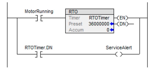

The Retentive Timer-On-Delay breaks away from the style of the other two timers in Studio 5000. The RTO counts when the rung is True but it does not reset when the rung goes False. It retains whatever counts it has accumulated. An easy way to visualize where this could be used is if a machine needs to be serviced every 100 hours of run time. You want the timer to accrue value when running, stop accruing when not running, but retain the count so that a notification can be displayed when the service interval has been reached.
PLC RTO
Figure 4. Retentive timer instruction.
In the logic in Figure 4, the RTO is laid out just like in the previous two examples. When the motor is running, the rung is true and we are counting. When the motor stops running, the counts are held while it waits for the next time the rung goes True. When the counts reach the preset, the Done bit goes True.
The RTO instruction begins counting when its rung goes True. It does not reset the counts when the rung goes False. It triggers the Done bit when the accumulated counts reach the preset.

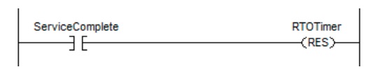

Reset (RES) Instruction
Our discussion of the RTO style timer demands our need to address an instruction that can be used in a multitude of places and capacities in Studio 5000. The Reset instruction can be used to reset the counts of ANY style of timer no matter where it is in its counting cycle. When the Reset is triggered, it resets the counts of its associated timer to zero. To associate the Reset with the timer you want, simply place the timer’s tag name into the tag of the instruction.
In this line of logic, you can see I have set up a Reset to be triggered when a user hits a button to tell the PLC that the service is complete for our RTO example above.
PLC Reset
Figure 5. Reset instruction for timers.
A reset instruction will take any timer and set its accumulated value back to zero. It also can be used to reset the value of a counter to zero, but that is better left to a different article scope.

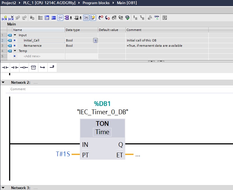

Despite the simplicity of timers, it is worth noting that there can be a wide range of differences between how a timer looks in Studio 5000 as opposed to another platform. In the following figure, you can see the timer structure used in TIA Portal from a Siemens PLC system. We have a rung entering the input of the instruction (IN) just like the Enable bit, a Preset Time (PT), an Elapsed Time (ET) which is equatable to the ACC, and finally a Q which represents the Output. The Q is comparable to Studio 5000’s Done bit.
In this instruction, the Timer Timing (TT) does not exist but can be formed with a simple series of IN being true, and Q being false.
TIA Portal TON
Figure 6. TON from Siemen’s STEP 7 TIA Portal software.

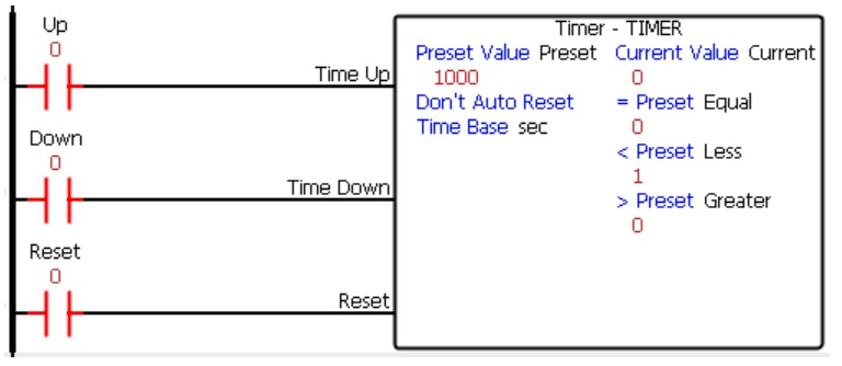

Productivity combines a lot of functionality into their single Timer instruction. It is inherently a retentive timer like the RTO, but you can choose to auto-reset as well as monitor when the current time is less than, equal to, or greater than the preset in the menu. It also has 3 rung inputs, one counts up, another counts down, and another resets. Automation Direct does this with many instructions, combining functionality so one instruction can perform a myriad of tasks.
Productivity Suite Timer
Figure 7. Timer from Automation Direct’s Productivity Suite.
Automation Direct also has a Simple Timer that works like a TON or TOF instruction. Just like the others, you must set the preset. Both of these timers are examples of time bases that can be changed to fit your needs, note in the previous figure listing the time base in ‘sec’ for seconds.
