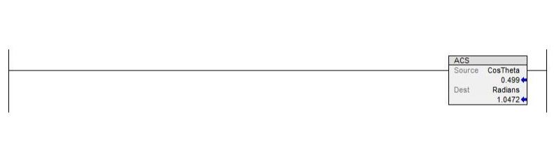

Using the ACS (Inverse Cosine) Instruction in Studio 5000
ACS instruction Studio 5000
Figure 7. ACS Instruction in Studio 5000 can be used to find the angle—you’ll need to divide your adjacent by your hypotenuse for your source number.
The ACS, or inverse cosine, as seen in Figure 7, allows you to find the angle if you have both the hypotenuse and the adjacent sides.
For your source number, divide your adjacent by your hypotenuse and plug in the result.

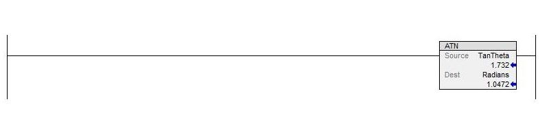

Using the ATN (Inverse Tangent) Instruction in Studio 5000
ATN instruction in Studio 5000
Figure 8. ATN Instruction in Studio 5000 can be used to find the angle—you’ll need to divide your opposite sides by your adjacent for your source number.
In a similar method to the previous commands, the inverse tangent allows you to find the angle if you have both the opposite and adjacent sides. This is perhaps the most common of the three inverse functions to use, since many linear axes can easily track the motion in the X and Y direction, but must use these two values to calculate the angle of diagonal travel.
For your source number, divide your opposite by your adjacent and plug in the result.
