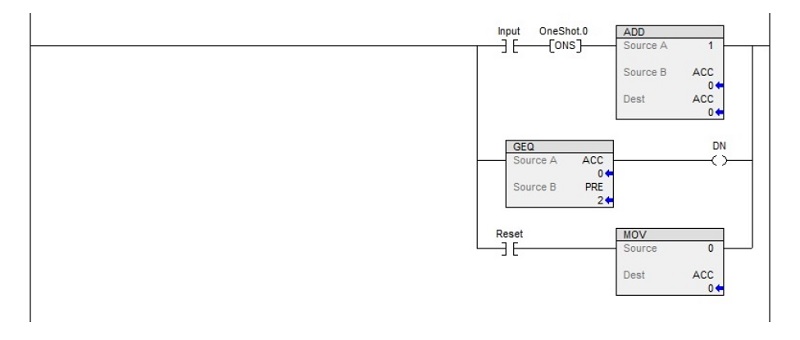

Let’s examine how the logic for a counter might look in Studio 5000 if such a pre-defined function wasn’t available (Figure 1).
PLC counter logic
Figure 1. An implementation of simple counter logic in Studio 5000. All images used courtesy of the author
The input triggers the One-Shot, and that adds 1 to the Accumulated Value (ACC). When the accumulated value matches the Preset Value (PRE), the Done bit (DN) is triggered. In order to reset the counter, we must trigger a Reset button that places a 0 in the accumulated value.
The operation is fairly simple overall; but what if you had 10 counters? You’re now dealing with 30 or more rungs and branches of logic, each requiring the individual, manual creation of named integers and booleans for each One-Shot, reset, count value, and status. To clean everything up, we could always turn to the counter instructions integrated into every ladder logic software IDE.

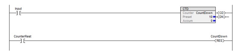

Rockwell Automation also has a dedicated Count Down instruction in Studio 5000. The CTD instruction works in a very similar way to the CTU as you would expect. As before, it’s a single-line instruction with a built-in One-Shot and external reset.
CTD Instruction
Figure 3. Count Down (CTD) instruction in Studio 5000.
Using this counter requires a little more forethought because, just like the CTU, the DN bit still goes true when the ACC is greater than the Preset Value (PRE). However, reset will still return the ACC value to 0, as it did with the CTU, so it may be necessary to use an MOV command to set the ACC value higher than the PRE, as explained in greater detail below.

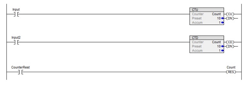

There are a variety of ways you can use this instruction. The primary way that comes to my mind is to use it in conjunction with a CTU instruction. Let’s build this and see what it might look like (Figure 4).
CTU and CTD
Figure 4. Count Up (CTU) and Count Down (CTD) instructions in Studio 5000.
When we trip Input, the CTU adds 1. When we trip Input2, the CTD subtracts 1. Because it is the same set of Counter tags (as indicated by the identical tag name ‘Count’ in both counters), the preset is the same on both. If you change one, it will change the other to match.
Another way you might use the CTD is to use a MOV instruction to place a larger number into the ACC which will cause the DN bit to become active, then count down to your PRE number and watch for the DN bit to turn off. It’s a little backward, but that’s ok. If you can generate clean and effective code, it’s ok that you think outside the box a bit, but be sure to document any unique methods out of respect for any engineers following you.

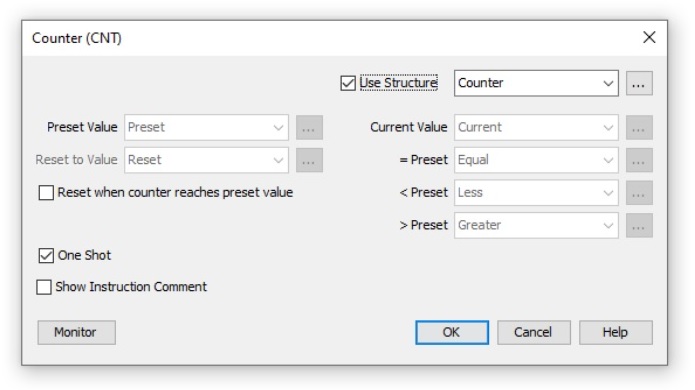

That is a little more complex, right? There count up, count down, and reset functions are all built-in. In addition to these 3 input functions, the instruction itself displays some additional settings found inside. Figure 6 shows the settings available when we open up the Counter instruction.
Productivity CNT
Figure 6. Counter instruction settings popup window in Productivity Suite.
We have a lot of bits we can use and a couple of settings to check. When we create our counter (I have appropriately named it “Counter”) using the ‘Structure’, we are given a variety of tags to use. We can tell the counter what its preset is, see its current value, and find out if it is equal to, less than, or greater than, the preset.
We can also tell it to reset when the counter reaches the Preset. This would be done in addition to the Reset input we have above in the logic.
Down in the bottom left, you’ll also see this counter can actually turn off its One-Shot functionality. I have never used this function, but you might!

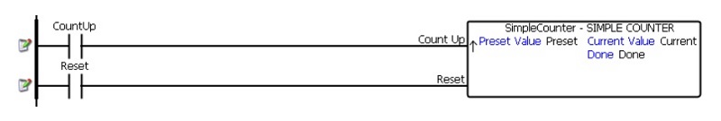

Are you looking at that counter and thinking, “I don’t need all that. I just want to count!” That’s okay. Productivity has another instruction that is more simple. Can you guess the name? You guessed it - Simple Counter.
Productivity SCNT
Figure 7. Simple Counter instruction in Productivity Suite.

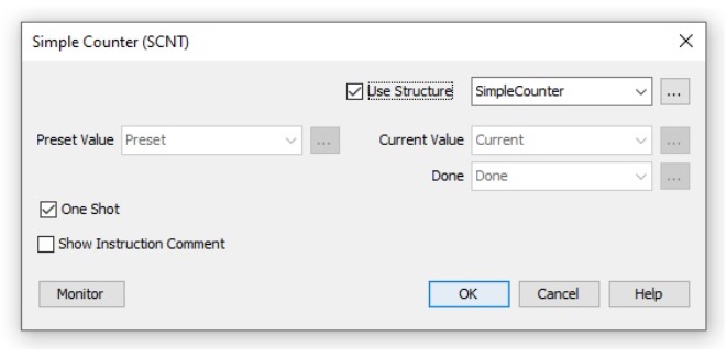

This is probably what you were envisioning when you thought about counters. A count-up input and a reset input. There are some additional parameters inside as shown in Figure 8.
Productivity simple counter
Figure 8. Simple Counter instruction settings popup window in Productivity Suite.
The only manipulation that can be done to this instruction is whether or not you want it to have a One-Shot. Mine always do, but, as I mentioned before, your system may not need the One-Shot.
