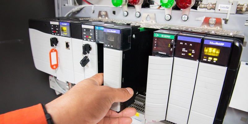

Rockwell PLC
Figure 1. I/O modules are always assigned to the controller (global) scope since the real-world data applies to all programs equally. Image used courtesy of Adobe Stock

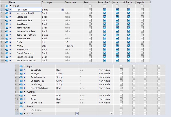

With Siemens PLCs, tags can be created in data blocks, or they can be defined inside function blocks and function calls. When tags are created in a program or FB and FC (function block and function call), only that program or function can access those tags. Building your ladder logic code this way allows for compact tag lists and compartmentalized code structure.
Siemens PLC tag listing
Figure 2. Global scope data (top) and the local variable of a function block (bottom) of a Siemens TIA Portal project. Author’s image

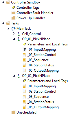

Rockwell Controller Organizer
Figure 3. Comparing the controller scope of tags in a Rockwell Studio 5000 project to the parameters and local tag menus inside each respective program. Author’s image

Another option is to have a program for each station, keeping all your tags local to that program. Input and output routines can take care of the I/O mapping and all your tags will have the same names. When code changes need to be made, it can be debugged in one program and when it's ready, you can copy and paste the code without having to change tag names.
By compartmentalizing your code into programs, you make it easier to reuse code in different locations, accelerating the integration of your machine.

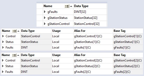

If I’m going to be using program and controller scoped tags within the same machine logic, I like to add a prefix to all global scoped tags so that I can quickly identify if that tag is defined in the controller or the program. Typically I’ll prefix the tag name with a lowercase g which represents global, and program tags would have no prefix.
Alias tag listings
Figure 5. Top image shows the global (controller scope) tag arrays, with the local aliases for two identical machine centers in the program scope tag lists below. Author’s image

Sometimes, you might have a requirement for a global tag which is used in every operation; fault arrays fit this bill. Faults need to be displayed on the HMI, but they will be set in the station programs.
With Studio 5000, you can define a global tag and then alias it to a local tag, so when the tag value is set in the program, the global alias will also be set. I like to define an array of fault tags and then alias an index from the array to the program fault tags. This can be confusing to read initially, but is a very clean way of connecting global and local tags together.
