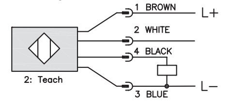

Sensor polarities are not always labeled directly on the device, but wiring diagrams are usually found on the body somewhere. A PNP sensor is recognized by the label attached to the signal wire (usually the black wire). It will indicate a + voltage, either by giving a direct + notation, or by showing a rectangular ‘load’ that also connects to the - line. If the sensor provides the + signal, then the input module must provide the opposite negative connection.
The diagrams below show a couple of actual examples of a PNP sensor wiring diagram. Notice in both cases, the black wire is connected to a rectangular 'load', the other side of which connects to the - signal line.
Figure 1. PNP sensor wiring diagram as found in a datasheet.
PNP Sensor
Figure 2. The PNP sensor wiring diagram is directly printed on the back of this sensor. Image used courtesy of Control Automation
