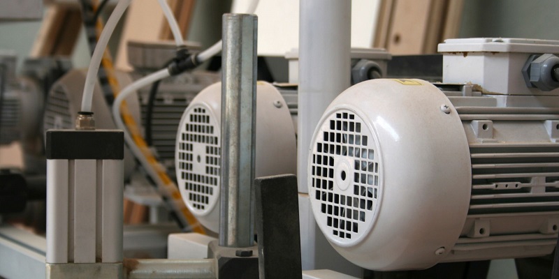

Most loads, like a motor, are inductive in nature, meaning that most power factor correction must negate the inductive reactive effects
Figure 1. Most loads, like a motor, are inductive in nature, meaning that most power factor correction must negate the inductive reactive effects. Image used courtesy of Canva
In the present day, the most common loads in the electric distribution system are inductive devices like motors, generators, transformers, etc.; therefore, the reactive load in the power grid is constantly increasing. The increase in the power of transformers, motors, and generators leads to an increase in reactive power, so the control of reactive power load has become imperative.

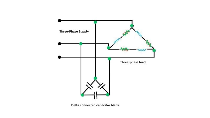

In a three-phase system, the capacitor bank is connected in parallel with the load in a star or delta scheme for power factor correction. The banks automatically switch on and off to maintain a desired power factor.
A three-phase load system with a delta-connected capacitor bank.
Figure 2. A three-phase load system with a delta-connected capacitor bank.

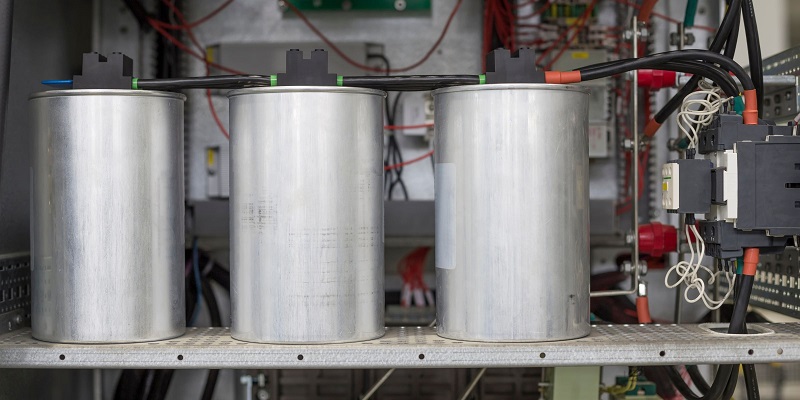

Capacitor Banks
In industry, the majority of the inductive loads are motors and transformers. Automatic power factor correction (APFC) panels or capacitor banks are used to improve the power factor. So then, why do we use a capacitor bank? The capacitor bank is one of the most common methods to correct and improve the PF by providing the reactive power that needs to be supplied by the source utility.
Inside any industrial system, we have both active and reactive powers. If the percentage of reactive power is high, then the system is inefficient, and the power factor will be low. So the reactive power has a direct relationship with the power factor; therefore, we should lower the percentage of reactivity to improve the system efficiency.
The inductive loads produce lagging reactive power (current lag voltage, lagging PF). To compensate for lagging reactive power in the system, we produce leading reactive power in the system with capacitors. The leading and lagging reactive power both compensate or cancel each other and is called reactive power compensation.
Capacitor banks may serve facilities or branch circuits, each chosen specifically for the reactance of its own loads
Figure 3. Capacitor banks may serve facilities or branch circuits, each chosen specifically for the reactance of its own loads. Image used courtesy of Canva

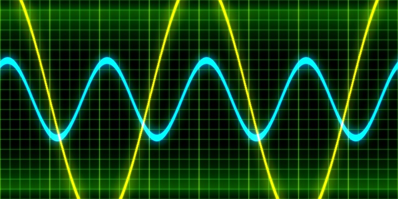

The view from an oscilloscope can measure the time delay (leading and lagging) between voltage and current waveforms
Figure 4. The view from an oscilloscope can measure the time delay (leading and lagging) between voltage and current waveforms. Image used courtesy of Canva

Finally, oscilloscopes can analyze the voltage and current waveforms to determine the power factor of the system.
