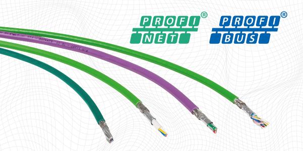

Figure 1. Profibus and Profinet are two widely adopted industrial communication protocols; often, the cables are color-coded. Image used courtesy of TE.CO.

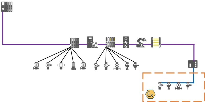

As far as system networks, line topology is popular, also known as daisy-chaining. Profibus works in a client/server (previously master/slave) modality. The client (or master) is the process controller that can be the PLC or another automation station, depending on whether DP or PA is used. The servers (or slaves) are all the sensors, actuators, and any other field component part of the network.
The client constantly polls each server in the network and receives response messages as requested, including the input data. This is done sequentially until all the servers have been polled, completing a bus cycle.
Figure 5. An example of Profibus line topology with daisy-chained clients and servers. Image used courtesy of Profinet

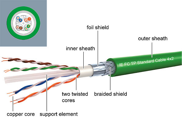

Profinet is an Ethernet-based protocol that provides greater transmission speeds and flexibility compared against Profibus. The Profinet cable employs the standard Ethernet cable wiring, plus shielding and other improvements to better withstand industrial environments. It is commonly a bright green cable with RJ-45 terminals. Although standard Ethernet cables can work, it is highly recommended to use shielded specialized Profinet cables.
Figure 6. A cross-section of a Profinet cable showing all of its additional protections. Image used courtesy of PROFINET UNIVERSITY
