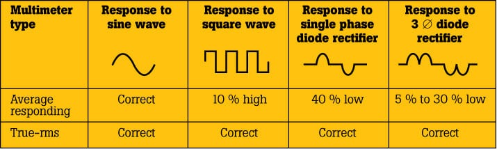

Key Differences Between RMS and True RMS
  • Applicability to Non-Sinusoidal Waveforms
    • RMS is suitable for sinusoidal waveforms and provides an accurate representation of their effective value.
    • True RMS is designed to accurately measure the effective value of both sinusoidal and non-sinusoidal waveforms, making it more versatile in real-world applications.
  • Circuitry and Accuracy
    • RMS meters typically assume a sinusoidal waveform and use simpler circuitry, providing accurate readings for ideal conditions.
    • True RMS meters employ advanced circuitry to accurately calculate the effective value of complex waveforms, ensuring precision in diverse and distorted signal environments.
  • Use Cases
    • RMS is commonly employed in situations where the waveform is expected to be close to sinusoidal, such as in power distribution and basic electrical measurements.
    • True RMS is indispensable in applications where non-sinusoidal waveforms are prevalent, including audio electronics, variable frequency drives, and other systems with distorted signals.
Error margins for non-true RMS measurements
Figure 3. Typical error values for normal RMS measurement compared to True RMS calculation for various waveforms. Image used courtesy of Fluke
