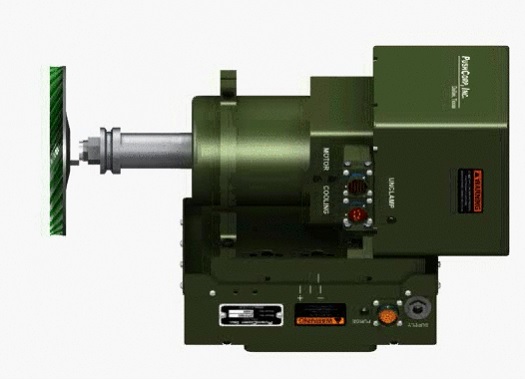

Figure 1. A single axis force compliance tool adapter. Image used courtesy of PushCorp

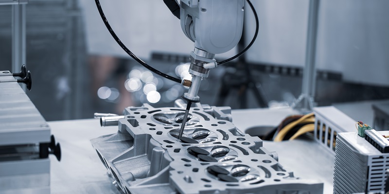

Force compensators and force compliance end effectors can be used in many different applications, not only grinding and part alignment. They give robotic arms or cartesian systems an enhanced way of accurately sensing the medium that they are working with. This expands the capabilities of six-axis robotics to include tasks that would otherwise need the guidance of a human hand.
Figure 2. A six-axis robot being used in precision alignment. Image used courtesy of Adobe Stock

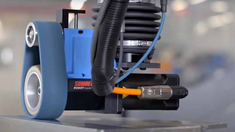

Figure 3. The Suhner EFC-02 can be used for controlled grinding and sanding. Image used courtesy of Suhner
An example of this is the Suhner EFC-02, designed by Suhner to be an active electric force compliance system. The Suhner EFC-02 can control the grinding force even on surfaces that are not uniform. Suhner was able to create this completely electric force compensator through the use of high-frequency force and acceleration measurement. The measurements are then fed through a control algorithm that can ensure a quality surface throughout the manufacturing process. It can be used in all orientations since it has six-axis measurement capabilities.

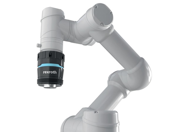

Figure 4. Render of a compliance tool on the end of a robot. Note the flexible rubber fitting which can allow linear movement and rotation along three axes each. Image used courtesy of Bosch Rexroth
Bosch Rexroth has a Smart Flex Effector that offers customers several benefits in one device. The device can be used to detect tool drift over time as the end effector works over its effective lifespan. This can be translated into position correction movements to keep the process in operation even with tool drift. The device can also be used to measure products, giving manufacturers a myriad of different applications. With measuring capabilities, the compliance sensor can be used to check tolerances on parts for quality control. It can also be used to search the part before beginning work on it.
