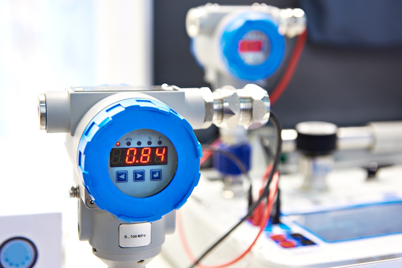

pressure sensor specifications on datasheets differ from other sensors
Figure 1. Sensor specifications found on datasheets will vary based on the type of sensor. Image used courtesy of Adobe Stock

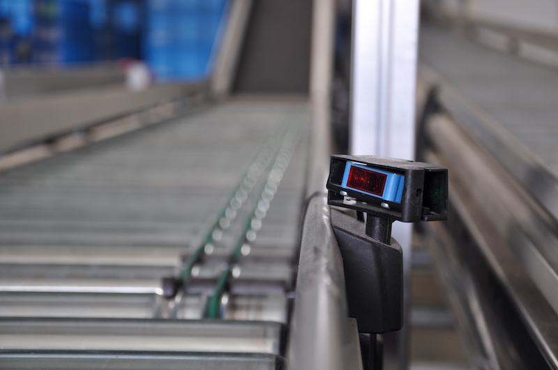

laser distance sensor
Figure 4. Laser distance sensor on a roller conveyor. Image used courtesy of Adobe Stock
