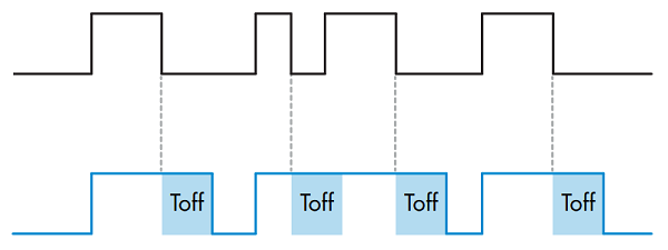

Off Delay
A sensor's "off delay" function isn’t exactly the opposite of an on delay as the name might imply. Instead of delaying the start of an action, it delays turning something off after the sensor stops detecting. For example, imagine a motion sensor in a room. When it stops sensing movement, instead of immediately turning off the lights, there's a delay before they go out. In manufacturing, the machinery won't stop immediately if a sensor with an off delay function detects an object leaving a specific area. Instead, it runs for a set period, allowing for a smooth transition or completion of a task before shutting down, like a cooling fan or a ‘motor running’ warning light.
The image below illustrates two different “off delay” scenarios: The input pulse in the first example remains low beyond the Toff time, and so the output (blue) signal also goes low. The second returns high before the Toff time is reached, so the output never goes low. In both of the final signal transitions, the Toff time is reached, so the final does become low.
Timing for an off-delay timer
Figure 2. “Off delay” timer functionality. Image used courtesy of Carlo Gavazzi

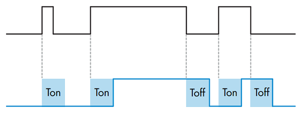

On/Off Delay
The "on and off delay" function in a sensor combines the features of both an "on delay" and an "off delay" to create a true delay before any kind of output event, either on or off.
When the sensor initially detects the object, there is a delay before the output starts, similar to an "on delay." Then, after the sensor stops detecting, there is another delay before the action stops, just like an "off delay."
When a sensor with an "on and off delay" function is paired with a conveyor belt, there will be a delay before the belt starts moving, then a second delay before the belt stops.
Timing for a combo on and off-delay timer
Figure 3. “On and Off Delay” timer function. Image used courtesy of Carlo Gavazzi
