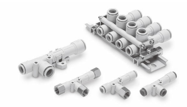

Single-stage ejectors are a common vacuum generation device for automation, mainly used in pick-and-place solutions. They consist of a housing that uses compressed air to create a vacuum by taking advantage of the Venturi effect.
Single-stage ejectors have the advantage of simplicity and can create a stronger vacuum when compared to multi-stage ejectors. This means they are useful in applications that require heavy lifting, especially pick and place where constant vacuum is not necessary. Single-stage ejectors can handle a certain amount of dirt and debris from the product since there are no moving parts and no air filter to plug with cardboard particles etc.

Figure 1. Body-ported type single-stage ejectors are compact and fit easily into tight spaces. Image used courtesy of SMC USA

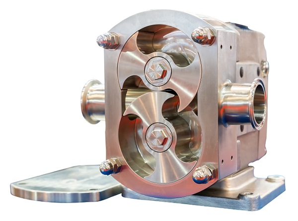

Single-stage pumps can be used to create low vacuum or high vacuum and there are many different sizes and types available to suit individual applications. Single-stage pumps offer a much higher volume than that of vacuum ejectors. The downside is the increased cost of a pump and the larger overall size of the system.

Figure 2. Vacuum pumps use vanes or lobes to create a vacuum. Image used courtesy of Adobe Stock
