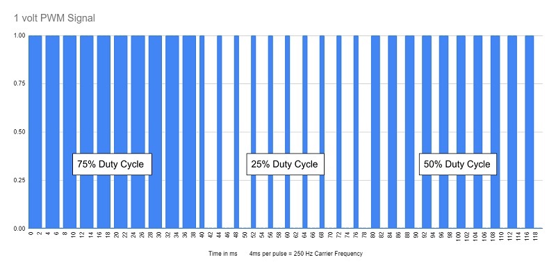

PWM Duty Cycle
The duty cycle of a PWM signal is the relative amount of time the signal will be on and is expressed as a percentage. If the duty cycle is 100%, the signal will be on all the time. If it is lowered to 50%, the signal will be on for half of the pulse and off for the other half. When controlling motors or heaters we use the duty cycle to dictate the power. If our PWM controller outputs a voltage of 12 volts DC, then a 50% duty cycle would provide the equivalent of 6 volts DC to power the load.
Figure 2. PWM signal showing various duty cycles at a 250 Hz carrier frequency.

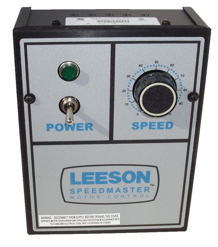

PWM for DC Motor Speed Control
DC motor speed and direction are dictated by the voltage applied - change or reverse the polarity of the voltage and the motor will respond in a similar fashion. Voltage can be changed by raising the series resistance within the electrical circuit, which in turn lowers the current through the motor. This change in voltage can be accomplished by series resistors, potentiometers, or rheostats. While these devices may be effective for small changes in voltage, the power and torque of the motor are decreased as the current drops. In addition, significant resistance from these devices can produce a lot of heat which could cause damage to other devices within the electrical system.
A more efficient way to vary voltage is to use a PWM controller. These devices use an analog input converted into a 0-100% duty cycle using the device’s rated voltage. Sometimes these devices will have a fixed input voltage but will drive a solid-state relay allowing the user to provide an auxiliary circuit to drive the motor using whatever voltage is appropriate for the motor. The reason a PWM signal is effective for motors is because of the spinning inertia of the motor. When the signal goes low, the motor is still spinning and has enough inertia to provide torque for that fraction of a second while the voltage is at zero. Warning: if the frequency is too low, the motor will appear to surge as it begins to physically catch up with the pulsing voltage.
Figure 3. DC Motor Speed Controller. Image used courtesy of Allied Electronics

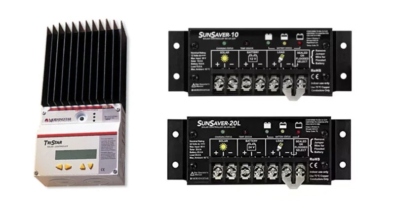

PWM used for Battery Charging
With electric vehicles becoming more popular, the technology involved with the charging stations is advancing as well. Solar panels are also becoming a popular trend within suburban areas as a means to lower electrical bills or give back to the environment. As the battery begins to fill to capacity, the power being transmitted to the battery needs to be decreased. By using a PWM controller, the amount of supplied power can be accurately controlled.
Lowering the charger voltage would be problematic as the battery voltage would eventually be higher than the small trickle charge would require and the battery would begin discharging.
Figure 4. Solar charge controllers. Image used courtesy of AltE
