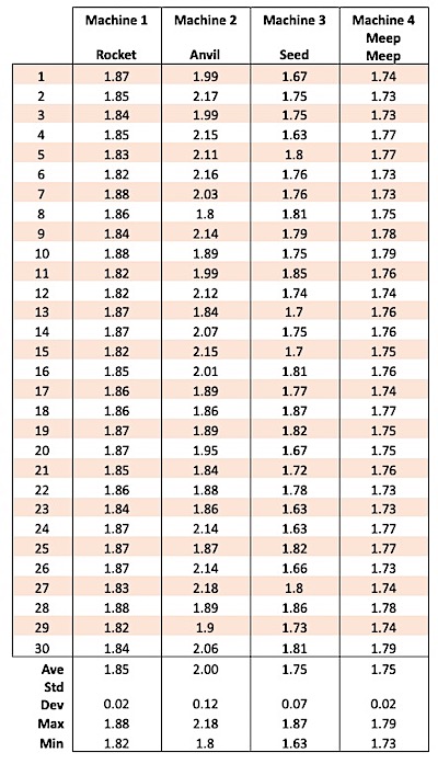

Now comes the tricky part: how do I know what values for this are good or bad? This is a tough question to answer without having context and a specification or something to compare to. To do this, let us set up four examples of data. For this example, we are going to look at the data from the (completely made up but successful) ACME 3D Printing Filament company.
This company has been getting complaints about the quality of its filament. They have four different machines that should produce a filament at a nominal value of 1.75mm ±0.05. We begin by digging into the data to understand the issue a little better. To do this, we look at laser measurement gauge data for filament diameter, measured in millimeters. This data represents a measurement taken at every meter of filament, so it is not too long. We only need to look at 30m worth of data from each of the four machines (shown in Table 1 below).

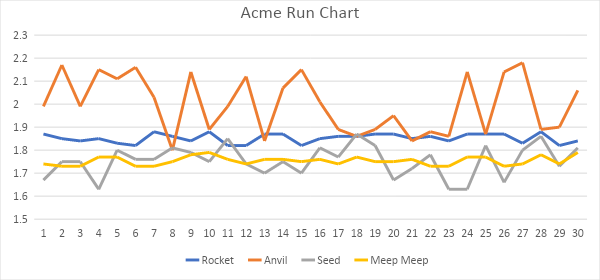

Figure 3 shows this same data in graphical form.
Figure 3. Filament machine production.
Here we can quickly see that we have some issues. Two of the lines, Anvil and Seed, are showing high process variation. In comparison to the other two lines, we can see the precision is off.
Looking at the standard deviation we have .12mm and .07mm respectively for each machine. This compares to Rocket and Meep Meep having standard deviations of only .02 each. The Rocket and Meep Meep lines are comparatively much higher precision than the other two lines, by almost an order of magnitude.
We have identified which machines are comparatively precise, but what about accuracy? Visually, accuracy is slightly less intuitive. In this case, the Seed and Meep Meep lines are more accurate than the Rocket and Anvil lines. Seed and Meep Meep have an average diameter of 1.75mm whereas the other two lines are 1.85mm and 2.00mm, respectively.
Which line is the overall winner? The Meep Meep line is by far the most accurate and precise. The worst line belongs to Anvil. It is stopping up the works in this factory.
Which line would I rather start working on to fix? Probably the Meep Meep line. Wait, you might say, I thought that this line was the best. Well, yes, it is the most precise and accurate, but it looks like we might only have a little better than a ±2sigma process. If we want to get to ±3 sigma, we have work to do. From there, I would then work on the Rocket line as it has a consistent offset. The other two lines with their high levels of variation will likely require more head-scratching to understand the different sources of variation.
