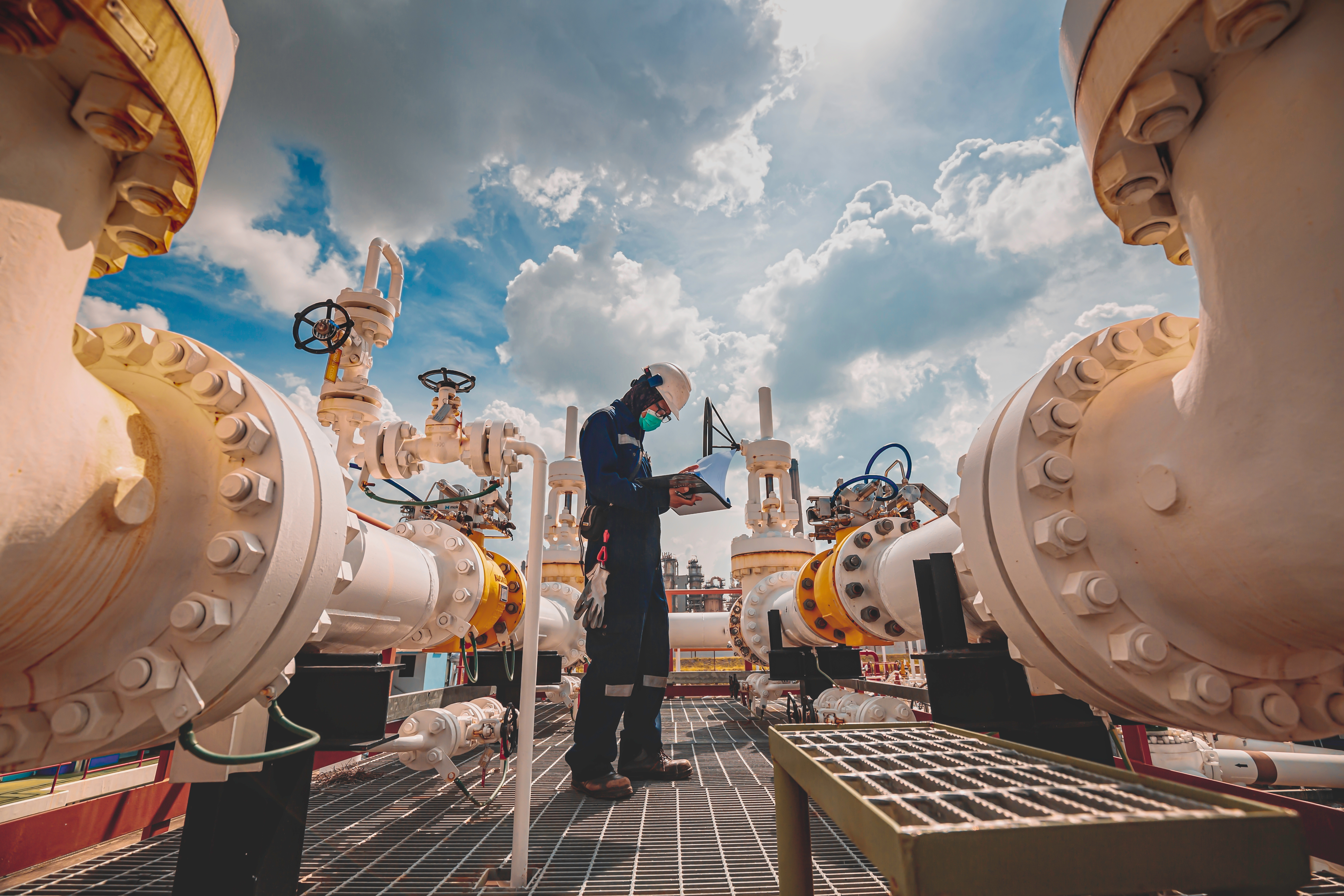

Safety valves perform the task of relieving pressure when a dangerous level has been reached.
Figure 1. Safety valves perform the task of relieving pressure when a dangerous level has been reached. Image used courtesy of Adobe Stock

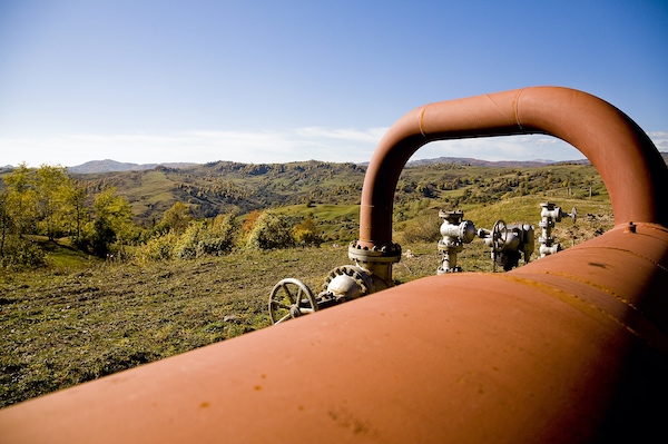

Common applications for protection in case of the excessive temperature of a liquid are closed vessels, long pipes exposed to the environment (sunlight), water heater applications, and pumps that recirculate water where heat buildup can be a problem.
Above-ground oil pipelines utilize thermal relief valves to protect from overheating caused by the sun
Figure 2. Above-ground oil pipelines may utilize a thermal relief valve to protect from overheating caused by the sun.
The operation of most of the valves is based on an internal spring allowing the valve to open if the force of the fluid expansion is great enough. This makes the operation quite similar to most common pressure relief components for hydraulic or pneumatic systems.
Since these valves are often placed in areas without each access to a control system, it is uncommon to find these valves controlled by a temperature sensor/processor/solenoid type of system. They must be able to operate in case of system failures, so they are designed to be extremely durable and operate properly without any supply of power or any communication with another part of the system.

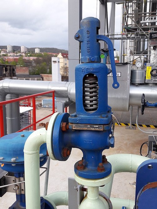

The construction of the pressure valves is similar to the thermal valves, usually using the force to open a spring-loaded valve to vent the excess pressure (Figure 2).
Figure 3. PSVs depend on a spring-loaded pressure relief valve that can vent excess pressure. Image courtesy of RomanM82 [CC BY-SA 4.0].
Often the spring is adjustable to allow different pressures to open the valve. Because of the more drastic changes, the valves, in this case, can be of quite a large diameter to vent more matter in a very short time.
