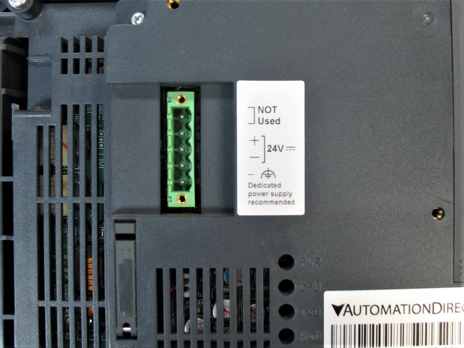

They usually mount to the front door of an electrical enclosure and are powered with 120V or 24V, depending on the type. The backside of the panel has the power connector and an array of communication ports.
HMI up close
Rear access for providing power to the HMI. Note the + and - 24V DC indicator - DO NOT power such a unit with 120V AC.

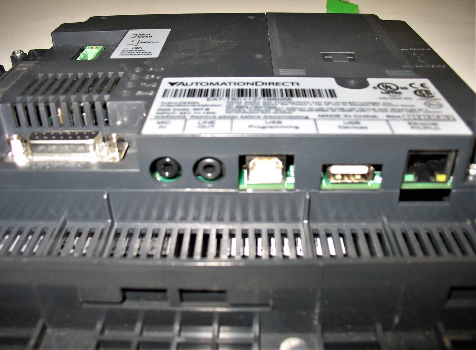

HMI up close
Bottom view of a typical HMI showing several USB, Ethernet, and various communication ports.
Inside a PLC, all information is handled by addresses which point to real-world devices or memory locations. To add an HMI into the operation, some of those memory locations are assigned to the HMI. The resulting process would look like this: an operator presses a ‘button’ on the screen, represented with a picture. The virtual button activates an internal memory location (or bit or tag, depending on the program). That memory location is sent to the PLC, which can examine its own program to see if that memory bit should turn on a motor or other function.
The connection to the PLC is most commonly achieved with an Ethernet, DeviceNet, or in some cases, an RS-232 connection interface.
