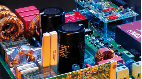

Power electronics is a field of electrical engineering that deals with electronic circuits to convert and control electric power. It is an extremely important field with wide-reaching applications since virtually every modern device is equipped with some form of a power electronics circuit. Some of the most common electronic components used for power conversion are diodes, rectifiers, transistors, thyristors, SCRs (silicon-controlled rectifier), and MOSFETs (metal-oxide-field effect transistor).
Figure 1. Power electronics are crucial elements present in nearly every modern electric equipment. Image used courtesy of Skyfi Labs

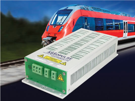

DC/DC converters are normally rated based on input and output voltage and current. Although many converters have a fixed output rating, some allow adjustment of the output within a range. Most converters count with a single output, but there are also options with dual and multiple outputs. Based on the primary function, they may consist of inductors, diodes, rectifiers, and filters.
absopulse dc-dc converter
Figure 2. High-power DC/DC converters are widely used in mass transit systems. Image used courtesy of Absopulse
For an efficient process, voltage regulator circuits employ power electronics to reduce noise and maintain a constant output. Well-designed regulators have an efficiency rating of 90% or above, which is an important consideration to reduce power loss and heat dissipation.

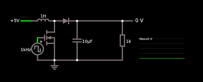

  • Step-up converter: Also known as a boost converter, the voltage output of this device is equal to or higher than the input while keeping the same polarity. This device works by storing energy in an inductor (L), which is allowed to flow to the output based on the biasing of a diode (D) controlled by a switch (S).
boost converter
Figure 3. A boost converter animation. Image used courtesy of Marino108LFS [CC BY-SA]

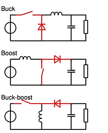

  • Step-down converter: Also known as a buck converter, the voltage output is equal to or lower than the input. The main difference between this and the boost converter is the placement of the diode and inductor. In this case, when the switch (S) is off, the equivalent circuit formed by the diode (D) and inductor (L) allows the stored energy to flow to the output.
  • Buck-boost converter: These devices generate a voltage output that can be lower, equal to, or greater than the input voltage. They offer the ability to reverse polarities, a common application. The circuit is a combination of the buck and boost converters.
buck vs. boost vs. buck-boost converters
Figure 4. Comparison of buck, boost, and buck-boost converters. Image used courtesy of Cyril Buttay

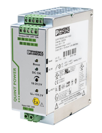

As mentioned, DC/DC converters have a wide range of applications, including industrial automation. A large number of field devices require 24V supply power. For instance, electrical panels are equipped with DC/DC step-down converters that lower the voltage from the main power supply. Some field devices not only require this voltage level but are also sensitive enough to need a clean and stable energy supply, which is another reason for integrating a converter.
phoenix contact dc-dc converter
Figure 5. An isolated DC/DC converter from Phoenix Contact. Image used courtesy of Phoenix Contact
