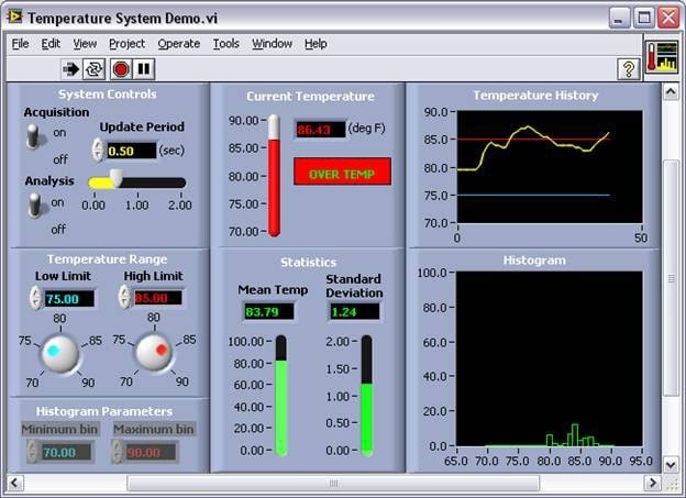

Many developers are leveraging the power of LabVIEW to create user-friendly human-machine interfaces (HMIs) backed by complex controls system algorithms and calculations implemented using a graphical programming language.
Figure 1. An example VI front end that shows some of the various controls and feedback tools available in Labview. Image used courtesy of NI

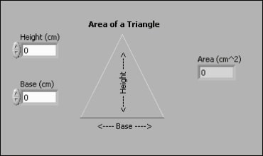

The image below shows a very simple front panel for determining the area of a triangle. The input parameters are height and base, while the indicator, which in this example serves as output, is area. Height and base can be adjusted, but area cannot be.
Figure 2. Simple front panel for calculating the area of a triangle using Labview. Image used courtesy NI

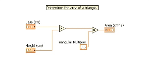

Continuing with the VI for determining the area of a triangle, the block diagram can take the form of the figure shown below. The controls are base (input of data type double) and height (input of data type double). The constant is triangular multiplier 0.5, and the indicator is area (output of data type double).
There are two nodes, both represented by a triangle with an x inside. Both nodes represent multiplication, and both require two inputs and generate one output. The indicator in this block diagram is area. The terminals are base, height, triangular multiplier, and area. The wires are the lines connecting everything together.
Figure 3. One possible block diagram for determining the area of a triangle using the front panel shown previously. Image used courtesy NI

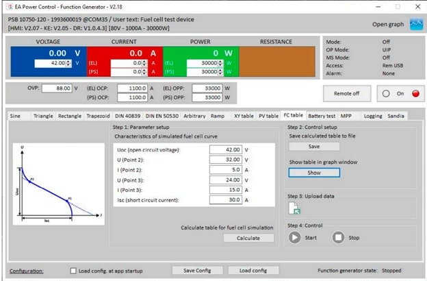

Figure 4. Example of a VI showing the fuel cell characteristic curve and defining the fuel cell output. Image used courtesy of EA Elektro-Automatik
LabVIEW is a unique tool for fuel cell simulation when the VI is created by a knowledgeable team who understands how the instrumentation is used and how to create effective HMIs.
An example of such an application is EA Elektro-Automatik’s VI for fuel cell simulation and testing that uses bidirectional DC power supplies and regenerative DC loads to simulate either a fuel cell or a real-world load acting on a fuel cell stack. Using LabVIEW, EA Elektro-Automatik aimed to develop an extensive group of VIs for controlling power supplies and DC loads for testing and tracking the behavior of a fuel cell system.
