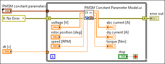

LabVIEW offers several ways to simulate a DC-motor control system. One way that you can use simulation in LabVIEW is by using the NI Electric Motor Simulation Toolkit. This toolkit enhances NI Veristand and LabVIEW. NI Veristand is another tool, providing the framework necessary to execute near real-time control, including motion control. Additionally, this makes it possible to run finite element analysis on the electric motor simulation.
With the Electric Motor Simulation Toolkit, new dedicated DC motor simulation VI’s become available in LabVIEW. There are also sample projects included that can be used for reference. One drawback is that there has not been a new release of the Toolkit since the LabVIEW 2016 compatible version.
Fig. 1. An example of a DC motor control VI created using the Electric Motor Simulation Toolkit. Image used courtesy of National Instruments

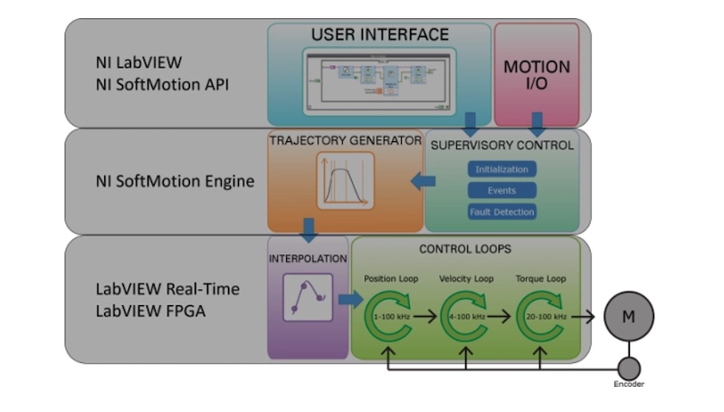

LabVIEW, used together with other applications from National Instruments, makes it possible to create motion control systems with all of the necessary components.
Input/Output Management
Using the NI SoftMotion application user interface, many components of the motion system can be added as modules in LabVIEW, including the control loop design.
User Interface
The HMI-equivalent of the system can be executed on and the LabVIEW Front Page.
Trajectory Generation and Supervisory Control
With the NI SoftMotion Engine, real-time control of the I/O is possible. The engine manages the configuration of the axis, as well as a simulation module to test the design before connecting the physical I/O.
Interpolation and Control Loops
Another module is the LabVIEW FPGA (Field-Programmable Gate Array), which upgrades the VI libraries to simplify coding in the data block.
The FPGA module makes it easier to configure and test the control loop and communication protocols. FPGA works together with the LabVIEW Real-Time Module, which helps compile the application that can be executed in an embedded hardware component.
Fig. 3. The different NI and LabVIEW modules needed to create a fully functional motion control system. Image used courtesy of National Instruments
Beyond single-axis control applications, these modules can be applied to complex multiple-axis control systems. For decentralized systems, the LabVIEW motion control environment has been developed to more easily integrate with devices that communicate using the EtherCAT protocol, which is ethernet-based. There is a wide variety of such devices that can be configured from one of the LabVIEW libraries. These methods are several ways you can use LabVIEW for motor and motion control.
