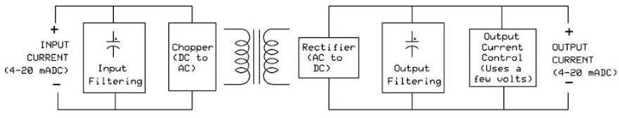

The isolation factor involves adding a transformer to the circuit. You first have to add a chopper to convert the DC to AC. You next add the transformer, and then convert the output back to DC. See Figure 1.
Functional block diagram of a loop-powered isolator
Figure 1. A loop powered isolator chops the DC signal to AC, adds a transformer for isolation, then turns it back to DC. Circuitry is added to make the output precisely equal to the input.
The details are not as easy as it would at first seem, though. All transformers have losses. If you were to use a 1:1 transformer, the output current would be a bit lower than the input. The current needs to be increased a bit, reducing the total voltage. Also, the losses change as the resistance changes. If everything is ok at, say, 100 ohms, the losses will change at 200 or 500 ohms. Even if the resistance remains constant, the linearity might be degraded by the change of voltage as the current increases or decreases.
Normally, the losses grow as the resistance increases. It takes additional circuitry to keep the output the same. You also need to filter the output.

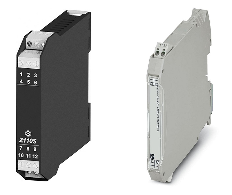

All the companies we are aware of use a 35 mm DIN rail to mount it, although the details differ. Here are two examples:
Two examples of loop-powered isolators
Figure 2. Comparison of two different loop powered isolators. Images used courtesy of Absolute Process Instruments and Phoenix Contact
