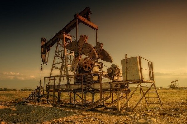

Drilling is involved in many industrial applications, including machining microscopic tools, large construction projects, and drilling oil wells. Drilling oil wells is a risky activity with a great deal of uncertainty about the surface to be drilled.
Figure 1. MWD and LWD are both prevalent in oil drilling.
Even with the advanced imaging techniques, it is difficult to determine the challenges the surface would present while drilling. For this, the oil industry widely uses measurement while drilling (MWD) and logging while drilling (LWD).
Both techniques are prevalent when oil wells are drilled at an angle to the surface. In fact, MWD and LWD are instrumental in enhancing the efficiency and capability of directional drilling. They also enable the drill operators to be in a zoned cabin, dramatically increasing the safety of the employees.

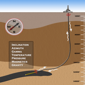

MWD was developed as a solution to the challenges faced when well drilling at extreme angles. At angles of 60o or more from the center, it is difficult to determine what comes next from the images, and drilling by ‘feel’ is a dangerous risk. For MWD, measurement tools are fitted in the drill bores and drill string. This allows for highly optimized drill steering as real-time data from the drill bore becomes available to the operator.
Important physical properties the drill operator needs to assess the surface being drilled are:
  • Temperature
  • Pressure
  • Borehole inclination
  • Azimuth
Figure 2. The factors required for MWD. Image courtesy of AONG.
Azimuth is the horizontal direction measured in a spherical coordinate system expressed as angular measurements. All these properties are measured in the borehole and relayed to the operator in real-time. With this information, the operator can drive the drill bore optimally and make informed decisions with tangible data.

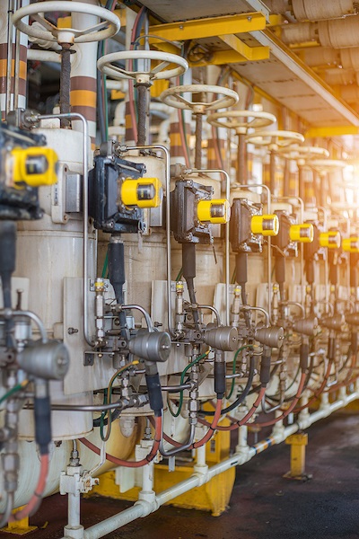

Figure 3. Production branch valve with feedback positioner controlled by a PLC in gas and oil field.
The information from MWD can be displayed on HMI with color-coding for easier comprehension. When the operation is comfortably within the range set by data from LWD, the visual indicators are green, and once it is beyond the comfort zone it displays with a yellow indicator. Once the data from MWD indicates that the range is breached, the drill head automatically stops, with a red indicator and alarms.
