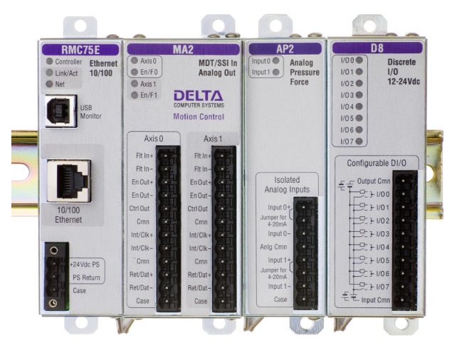

Delta Computer Systems’ RMC75, an example of a PID controller with expanded I/O capabilities. Image used courtesy of Delta Motion.

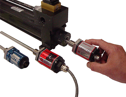

A linear position sensor made by Temposonic and used to locate the precise location of the shaft of a hydraulic cylinder. Image used courtesy of MTS Sensors.
For those hydraulic cylinders, the sensor must return back the precise position of the end of the cylinder. Usually, it must be precise down to fractions of an inch or millimeter. Most commonly, the center of the cylinder is hollow, giving room for a long sensing rod that works on principles of magnetic fields - often field disturbance or Hall Effect sensing. Sometimes these are named by brand, including Temposonic, a common choice for hydraulic applications.

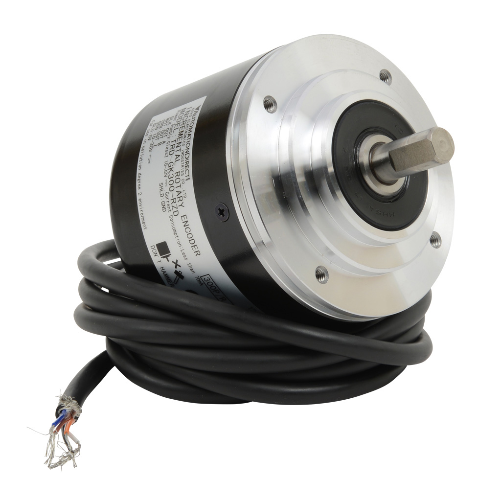

With motor drive systems, the encoder is almost always the choice to retrieve information about RPM. For continuous motion, the rotational speed is the end target parameter. For linear electric motion, an encoder can still be used but magnetic tape position sensors or even linear potentiometers can be employed. Although the latter usually only for very small ranges of precise motion.
A rotary encoder for heavy-duty applications. Image used courtesy of Automation Direct.

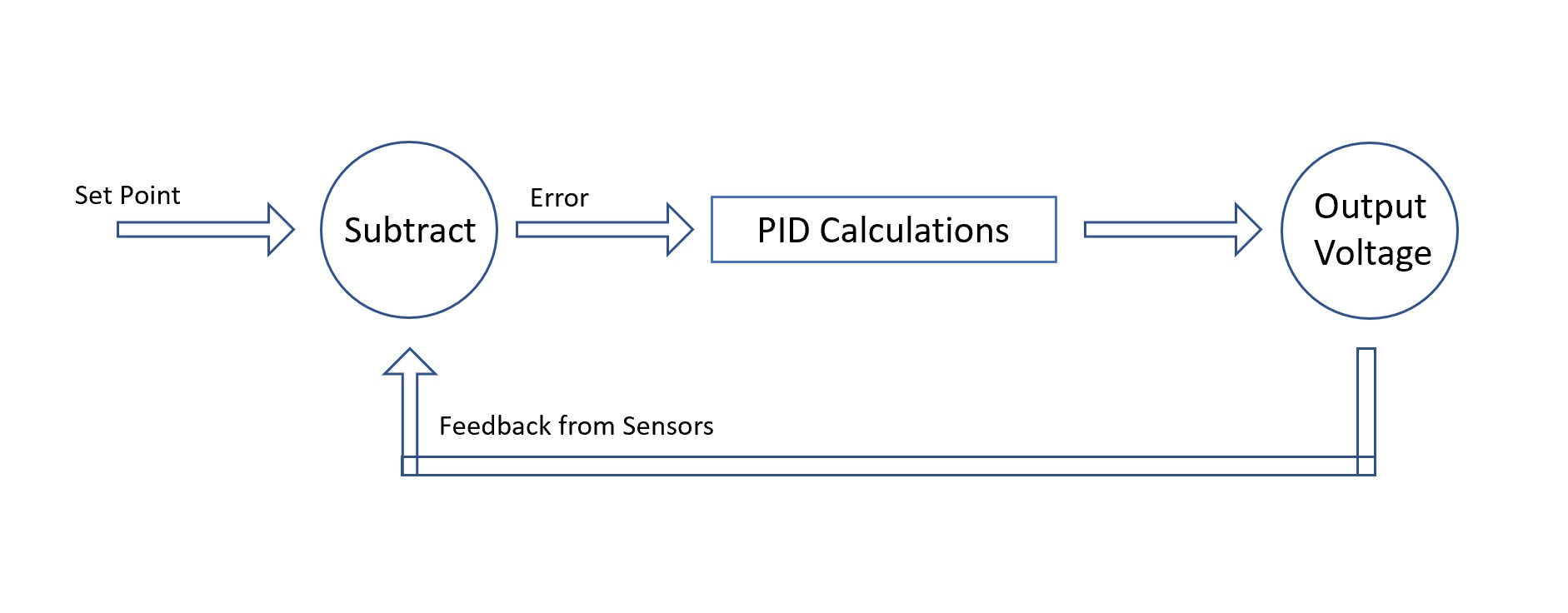

Each time a reading is obtained, the current value is compared with the target set point, and the difference (again, subtraction) between them is called the ‘error’.
A typical ‘block diagram’ representing the loop from output voltage, back through a feedback loop, and compared to the set point to determine the error.
