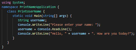

Python can be very portable and easy to adopt because the language has all high-level programming capabilities. It is fast and intuitive to develop an application with Python. For a simple example, the code can be written in C# in Figure 1 to ask and print a username.
Figure 1. Simple C# Code

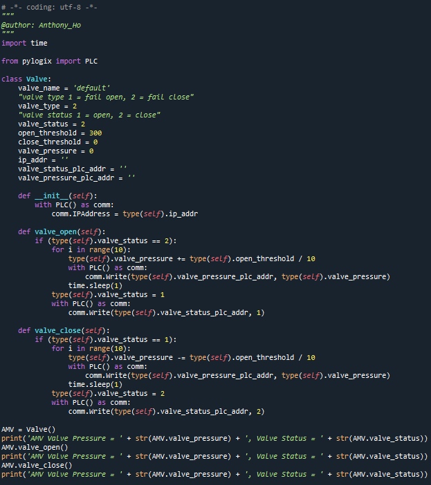

To create a Valve class, Python provides a fast and easy way to create the class, as illustrated in Figure 3.
Figure 3. A Valve class and its implementation

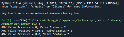

After running this piece of code, it yields the result in Figure 4.
Figure 4. Result of running the Valve Class implementation

To write to the PLC, the programmer only needs to fill in the PLC’s IP address and the register addresses of the valve status (valve_status_plc_addr) and pressure (valve_pressure_plc_addr).
As you can see from the valve example, I used pylogix in my project. Pylogix is a free library that allows the application to easily read/write values from tags in Rockwell Automation Logix based PLCs such as CompactLogix and ControlLogix over Ethernet I/P using Python.

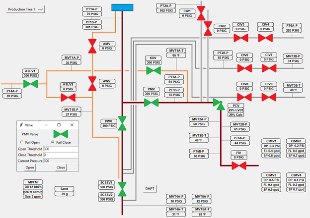

As a result, a simulation for a typical subsea field was created, and the GUI of a subsea production tree is shown in Figure 5. The GUI for each Production Tree contains various object instances, such as valve, choke, pressure/temperature transmitter, multi-phase flowmeter (MPFM), sand detector, and downhole gauge for pressure and temperature (DHPT), etc. These objects were built using the same process as building the valve object.
Figure 5. The GUI of a typical subsea production tree
The diagram depicts one Production Tree. Different Production Trees can be chosen using the dropdown box on the top left corner. In this prototype, I created 100 Production Trees with minimum effort as the production trees are identical in structure. Furthermore, the number of Production Trees in the simulation package did not significantly impact the overall simulation performance.
Popups are used when the user clicks on the object instances.
Replication of subsea trees is straightforward by copying one tree to another and changing the object instance PLC addresses. Customizing the simulation package to a specific subsea field will simply involve re-arranging the objects and changing the equipment labels and PLC addresses, etc.
