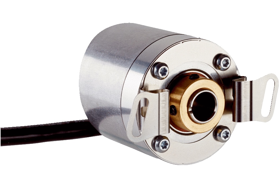

Open Collector Incremental Encoder. Image courtesy of SICK Sensors
