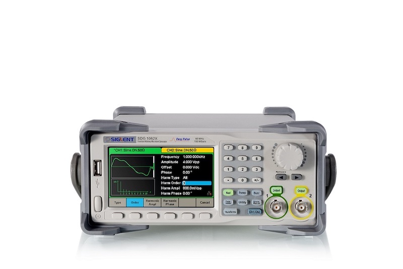

Figure 1. Many modern oscilloscopes are equipped with RS-232 ports. Image used courtesy of Siglent
One of the main reasons for the interface’s longevity is its simplicity. Serial communication can be established with as little as two wires, making it suitable for microcontrollers and PCBs where the number of pins available is minimal. Although data transmission speeds are lower than most protocols, it is still an adequate solution for many of the aforementioned devices.

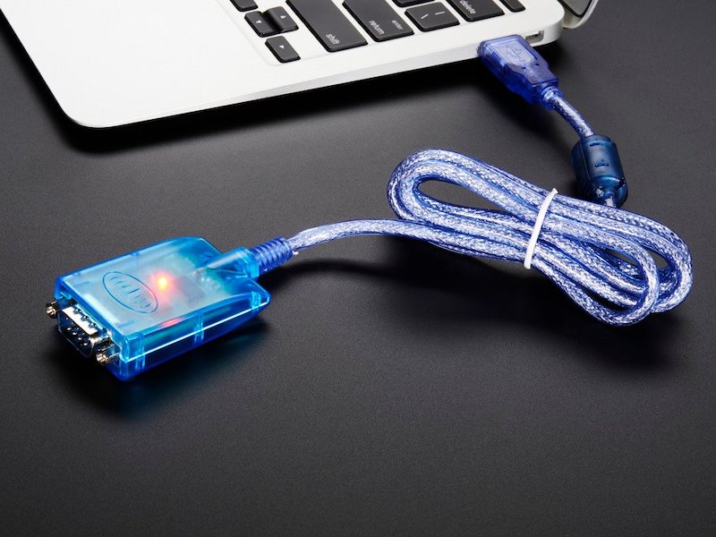

To begin the communication setup of a serial-based instrument with LabVIEW, the device must first be connected to the computer where the application is executed. Considering that personal computers equipped with serial ports can be hard to find nowadays, then to achieve this physical connection, USB-to-serial adapters can be used.
Figure 2. USB-to-serial (RS-232) adapters are needed to connect serial devices to personal computers. Image used courtesy of Adafruit

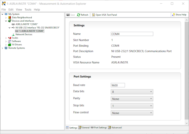

With the device connected and the NI-VISA driver installed, the NI-MAX tool can complete the configuration. Relevant serial protocol parameters, such as baud rate, data bits, parity, and flow control, are set up for the serial port ID where the instrument is connected. It is important to know these values from the instrument itself to successfully establish the communication.
Once the setup is completed, the newly added device becomes a VISA entity that can be added into the block diagram in LabVIEW. From there, functions such as serial port open, close, read, and write can be programmed on the VISA entity, which gets executed on the connected instrument.
Figure 3. Setup of a new RS-232 instrument using the NI-MAX tool. Image used courtesy of National Instruments

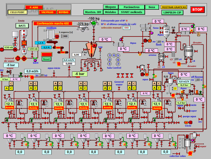

Figure 4. An example of a SCADA created in LabVIEW. Image used courtesy of National Instruments
LabVIEW offers the Modbus API to facilitate the integration with Modbus systems. The API allows the creation of server/client systems for sending control messages to connected devices. Information requests, or polling, is also available in the I/O configuration. With this API, a fully functional SCADA can be created in the front panel of the application.
