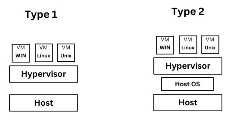

Hypervisor Enables Virtualization
The hypervisor is critical software that runs on top of the compute host and virtualizes all the components of the host. The compute host could be a server, desktop, or laptop. The compute host is just the physical hardware, containing the 3 main components of the CPU, RAM, and network adapters.
Usually, one physical host (like your laptop) is only usable by one single person, but if the computer is a powerful machine, then we can spread out the host power to users and workloads to take advantage with the help of a hypervisor.
Virtualization abstracts the operating system running on the physical hardware and creates a ‘virtualization layer,’ separating the CPU, RAM, and network cards into the virtual machines running on the physical hardware. The machine on which the hypervisor is installed is called a guest host and different operating systems installed on the hypervisor are called guest virtual machines. The hypervisor pools the resources from the physical server and allocates them to virtual workloads. There are 2 types of hypervisors: "Type 1 Hypervisor” and “Type 2 Hypervisor”.
Hypervisor types 1 and 2
Figure 1. Type 1 and Type 2 hypervisor difference. Image used courtesy of the author
Type 1 Hypervisor
The hypervisor is directly installed on the physical server without installing any operating systems like Windows and Linux. So it means there is no layer between the hypervisor and the physical server. They are also called bare-metal hypervisors and are most commonly used in the industry. The hypervisor allows us to create single or multiple virtual machines, with each VM thinking that it’s running directly on the physical hardware, as shown in Figure 1. The most popular hypervisors are EXi, Hyper V, and Oracle V.
Type 2 Hypervisor
This type of hypervisor does not run directly on the physical server, but rather on the operating system layer running in between the hypervisor and the physical machine. Any operating system like Windows, Redhat, or Centos directly runs on the physical machine. Then, on top of that host OS, the hypervisor is running. Type 2 hypervisors are also called hosted, and they are less common than type 1 hypervisors due to latency. Some examples of type 2 hypervisors are virtual boxes, VMware workstations, or virtual PCs.

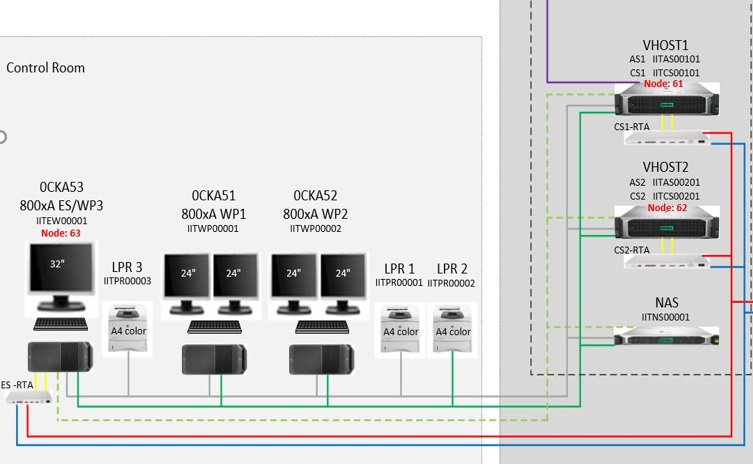

Leveraging Virtualization Technology for Industrial Control Systems
ABB has incorporated virtualization at the server level and selected VMware ESX hypervisor, which is available for users of System 800xA. System 800xA can be installed on two physical servers as shown in Table 1 below.
VHOST1 AS1: Aspect Server
CS1: Connectivity Server
DC1: Domain Controller 1
vCenterServer
VHOST2 AS2: Aspect Server
CS2: Connectivity Server
DC2: Domain Controller 2
BackupServer
Client Workstations WP1: Workplace
WP2:Workplace
ESW: Engineering WorkStation
Clients are not virtualized and are installed in the conventional way
Table 1. ABB System 800xA Redundant Aspect/Connectivity Virtual Servers distribution on physical hosts.
The one physical server named “VHOST1” runs a single instance of aspect server, connectivity server, and single domain controller along with vCenterServer, which is used to manage multiple ESXi hosts running multiple VMs.
Similarly, the VHOST2 runs the second aspect server, connectivity server, and domain controller, and it serves as a backup server for the virtual machine.
ABB hypervisor structure
Figure 2. Typical ABB System 800xA network schematic, 2 physical hosts with hypervisor running VMs, and operator workplace in CR. Image used courtesy of the author
