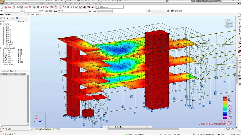

Analyzing the structural supports that factory automation interacts with often requires FEA to be verified and validated to ensure the model and results are accurate. Image courtesy of Autodesk.

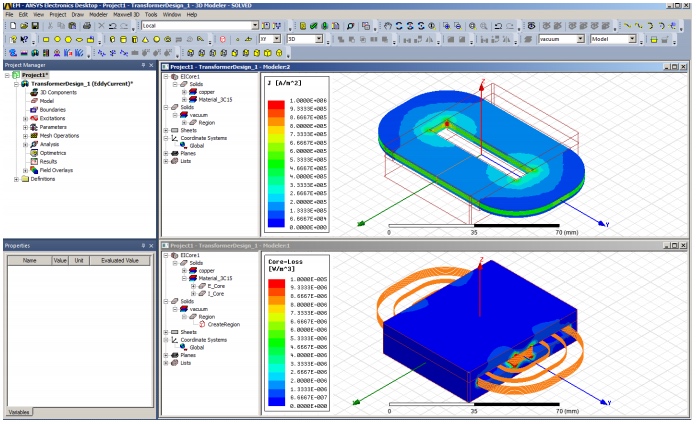

3D transformer simulations such as this one are performed in FEA packages that have been thoroughly verified before release. Image courtesy of ANSYS.

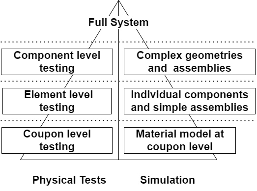

One of the tools used to evaluate computational models, including FEA models, is the validation pyramid.
In this process, the first step is to validate that the material is being modeled correctly by comparing it to the known behavior of a sample.
As one proceeds further up the pyramid, the model increases in its complexity. If at any point, the FEA simulation results do not coincide with the results of physical testing, then the model will be updated until the results are acceptable.
The validation pyramid.
Another way of looking at FEA model validation is, to begin with, a very simple model that you can confirm with basic calculations or laboratory tests.
As soon as the results at that level are correct, you increase the complexity. Never should an FEA simulation begin with the full system in all its complexity.

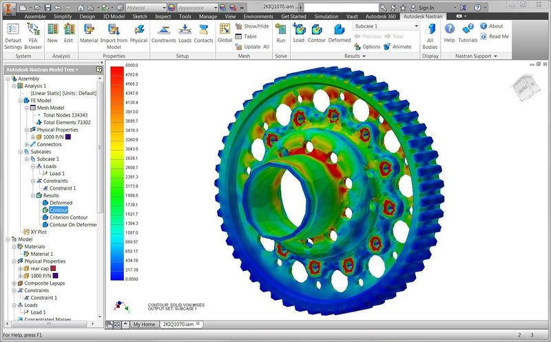

A single gear under analysis that will later be combined as part of a gear assembly. Image courtesy of Autodesk.

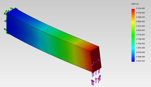

Cantilever beam fixed at one end with a transverse shear load applied at the free end. Image courtesy of Dassault SolidWorks.
The next phase of verification might include a simple beam deflection problem with one end constrained, the other end free, and a distributed load applied across the top of the beam. The beam will bend downward with a linear distribution of deflection, strain, and stress.
The deflection at the tip of the beam can easily be calculated, as can the maximum stress and where it should occur. As with axially loaded beams, such calculations can be found in every undergraduate level solid mechanics textbook.

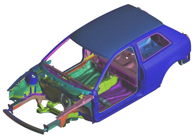

This FEA model would be a partial structure whose individual components had each been individually validated before assembly into a complete structure. Image courtesy of MSC Nastran.
As an example, consider how FEA analysis is performed on an automobile that includes components and structures made from aluminum, steel, polymers, and polymer composite materials.
While the behavior and material properties of aluminum and steel are already built into many FEA analysis programs, additional effort must be put into correctly setting up the composite materials because their behavior varies based on their orientation with respect to loadings. That is why the first level of the validation pyramid includes test coupons.
Once that is complete, individual components and simple assemblies, often consisting of basic structural elements such as the car chassis or the door frames, are modeled and validated.
Once validated, they are combined to form more complex assemblies (adding the composite door to the door frame and chassis, including the plastic bumper). Finally, the entire automobile is modeled and validated.
