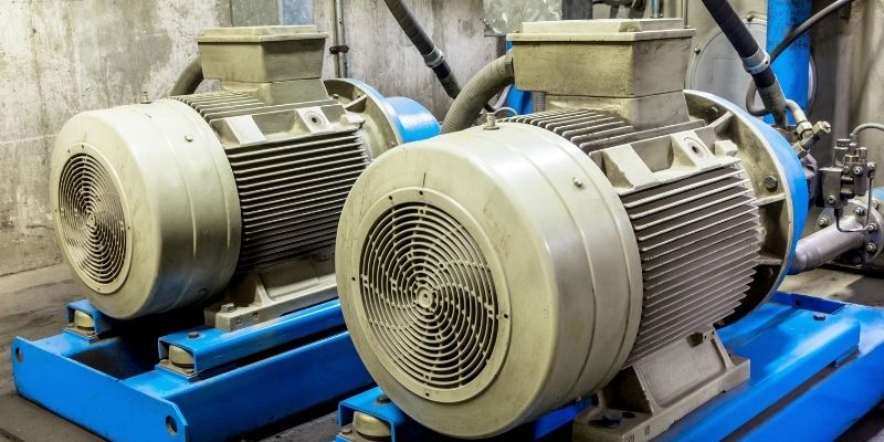

3-phase motors
Figure 1. Industrial 3-phase motors with VFD controls. Image used courtesy of Canva

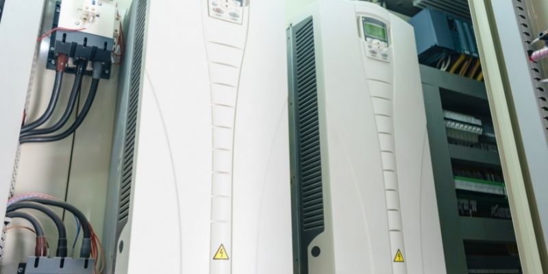

VFDs
Figure 2. Variable frequency drives (VFDs) allow safe and controlled responses to network failures. Image used courtesy of Canva
Quick Stop Function
VFDs come with an emergency stop function. Some device manufacturers have a quick stop function, in addition to that. The emergency stop function is generally activated by operators during distress situations. Quick stop functionality is different, being instead a protocol to quickly stop drive rotation, in a predefined manner, that need not be an emergency.
When you design a VFD implementation in your plant, you can design it in such a manner that the quick stop function is activated when a network outage is sensed. Access to these network outage responses is usually through the parameter menus. Most OEM software also lets you vary the deceleration curve for quick stop functionality. Using this function allows you to automatically stop the drive connected to the VFD in case of a network outage.
The quick stop function can be implemented in operations where a network outage is least expected. It is a better solution when the drive controlled by the VFD is not critical to the operation. When the drive is not required to run without fail, the quick stop function can be used to handle network outages. The quick stop function is not always an optimal way to manage network outages, but works well in a pinch when an immediate equipment halt is the best choice.

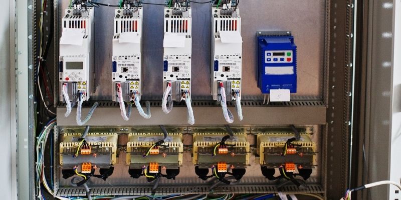

VFDs with inputs
Figure 3. Some VFDs will use backup manual or edge controls to run the system if network power is lost. Image used courtesy of Canva
Presets can be used when the available VFD does not have a quick stop function or when edge computing is not available. They are the way to go when drive operation is critical and should not be hampered due to network outages or other external factors. Extreme caution has to be exercised while designing presets for VFDs during network outages.
