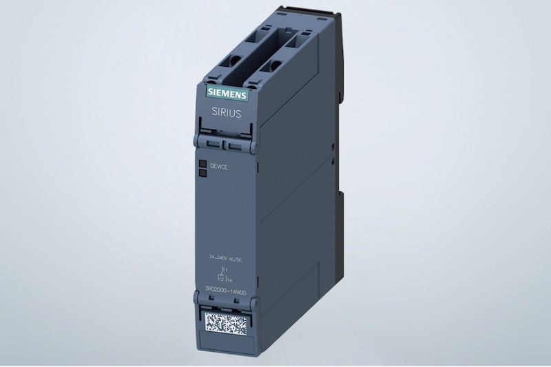

The signals from the physical sensors, such as temperature, are often small in amplitude. Their small amplitude makes it difficult for them to feed to the DAQ system directly. In addition, it makes the input signal an easy target for noise from various sources, altering the valuable data in the signal.
Figure 1. A standard signal converter. Image used courtesy of Siemens AG
Signal conditioners can amplify the incoming signal values that are easily detected by the DAQ. Amplification to higher values also helps separate and remove noise without disturbing the original data from the sensor. The amount of amplification level depends on the gain values of the signal conditioner.

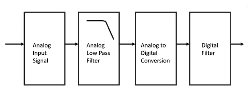

Filters are electric circuits that block the selected frequency range signals and read signals of the specific frequency range. There are various reasons to block these signals, particularly one crucial reason is to filter out noise.
Noise signals are identified as selective frequency signals or particular bandwidth. Most noise signals have higher frequencies than the original signal. The filter allows low-frequency signals to pass on to DAQ while rejecting frequencies of higher values. This filter is called the low pass filter.
Figure 2: A block diagram of an analog-to-digital signal chain with the analog filter before the digital filter. Image used courtesy of Digi-Key Electronics
The filter comprises either active or passive components. The passive filter includes resistors, capacitors, and inductors. The active filter consists of operational amplifier transistors, in addition to passive components. In addition, some signal conditioners have a selectable range for allowing and blocking a particular frequency range.
Low pass filters are also used as anti-aliasing filters to block under-sampled signals. Under-sampling occurs during sampling of an analog signal when the sampling rate is not greater or equal to twice the highest frequency, called Nyquist Theorem. If the Nyquist Theorem is not followed, it will result in false lower frequency components in the output. The filters are used to remove these false low-frequency signals.

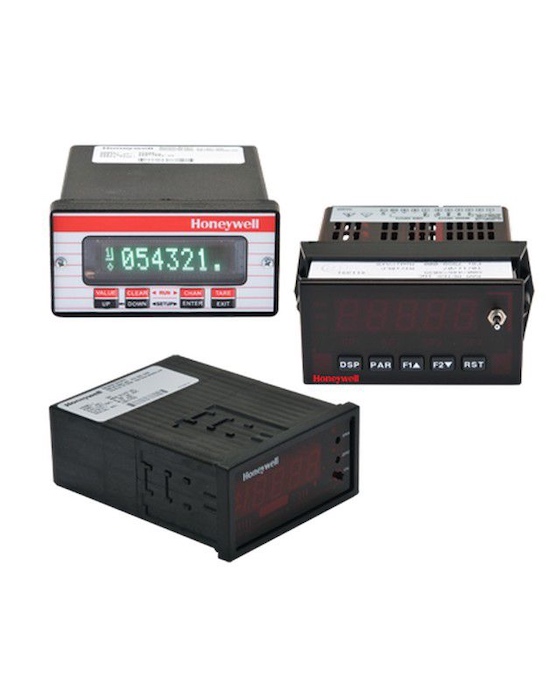

Some output from sensors does not have a direct relationship with the input physical parameter. It is only in rare cases, such as temperature, that this rule is followed. Instead, they have an exponential relationship between them. In thermocouples, the output relationship with the input signal changes as the temperature increases, and it becomes more exponential at higher values.
Figure 3. Several display and conditioning devices from Honeywell. Image used courtesy of Honeywell
Signal conditioners are used to linearize the relationship between the input and its corresponding output. The output can be the standard format of 4 – 20mA, or 0 – 10 V. Linearization allows the work to scale the inputs from physical parameters, resulting in meaningful information from the data acquisition system.
