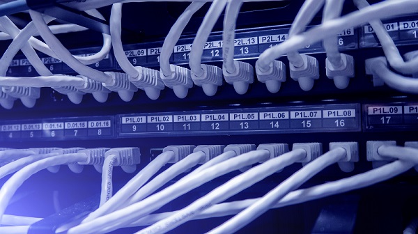

Figure 1. Switches are the primary distribution point for device-level networking. There are managed and unmanaged network switches. Image used courtesy of Adobe Stock
