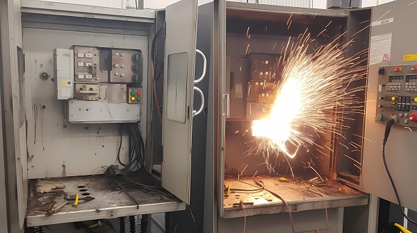

Electrical shorts are a common instrumentation problem in which the positive and negative terminals of a power supply (including batteries) are connected with no resistance, causing a short circuit condition.
Sparks and fire in a faulty control cabinet
Figure 1. Sudden sparking explosions are usually due to short circuits. Increased resistance from corrosion can also lead to fires but through the slower process of overheating. Image used courtesy of Adobe Stock
In the context of voltage measurement, a short will not result in failure. Many technicians directly measure the voltage at the supply terminals. However, when measuring resistance or current, it will likely result in a malfunction of the connected instrument, and in many cases, the device becomes dead and inoperable. Regardless, damaged insulation, exposing the conductor, is the most common cause of electrical shorts. To prevent electrical shorts from causing further damage, be sure to test resistance only when the circuit is powered off or disconnected. Be sure also to only measure current with a non-contact meter, or if you are certain that a series resistive load is securely connected.

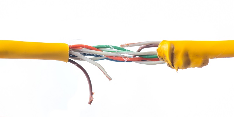

Wire disconnection, as the condition suggests, is the discontinuation of wire carrying signal information such as 4–20 mA or 0–10 V in the instrumentation system. Also referred to as an open circuit condition, disconnection usually results from dust exposure, high temperatures, vibration, or shock. Disconnections can also occur when wires are woven together to form cable, rather than a single-wire solid metal conductor.
Broken open wiring failure in a CAT6 cable
Figure 2. Wire disconnect is a common problem in measuring instruments and can occur due to dust, stress, high temperature, and using fragmented pieces of cable, instead of a single cable. Image used courtesy of Adobe Stock
When wiring disconnections occur, the values on the instrument display may appear either random or show the maximum data value. Random values can be generated by a nearby EMI source inducing voltage on an open wire. If EMI is not a factor, the most likely values to see are 0 volts if neither wire end is connected to an energized source, or maximum signal voltage if one wire is connected to an energized voltage source.
In process control instruments, the HMI display may exceed a user-defined threshold limit when the circuit is disconnected, and the display may default to an invalid reading, such as “### or ***” for example. This event may also trigger an alarm, indicating failure to read specific process variables.
