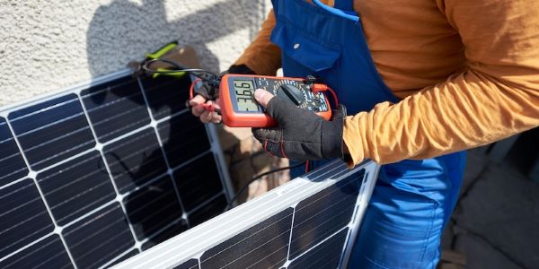

Voltage measurements in a live circuit can point to certain behaviors and failures, and as long as the work is done safely, the voltage can provide nearly everything a technician will need to know without harming the circuit under test. As an added bonus, the test tools (voltmeters) are very inexpensive.
We often teach the concept of a ‘voltage drop’ or ‘voltage difference’ in a circuit without much explanation of how or why the volts are dropping. Yet the daily task of an electrical technician is to use the two leads of the voltmeter to locate a problem.
Figure 1. Technicians use voltmeters regularly to find problems related to voltage drop.

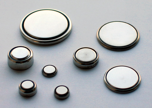

If the supply cannot reach a high current (such as a AA battery or small coin-cell battery), then the above scenario is correct until the resistance begins to decrease. The charge motion will try to climb, but the battery cannot provide such current. Since the current no longer increases, neither does the energy consumption, and the voltage maxes out below the rated voltage.
Figure 4. Coin-cell batteries can only provide a certain amount of current. Without the current and energy increasing, the voltage maxes out below the rated voltage. Image courtesy of Gerhard H Wrodnigg. [CC BY-SA 2.5]
This is called the ‘loading effect’ of a circuit. When current is demanded, the supply voltage will drop. If a short-circuit is reached, expect the supply voltage to drop dramatically, but it depends on the capacity of the supply.
