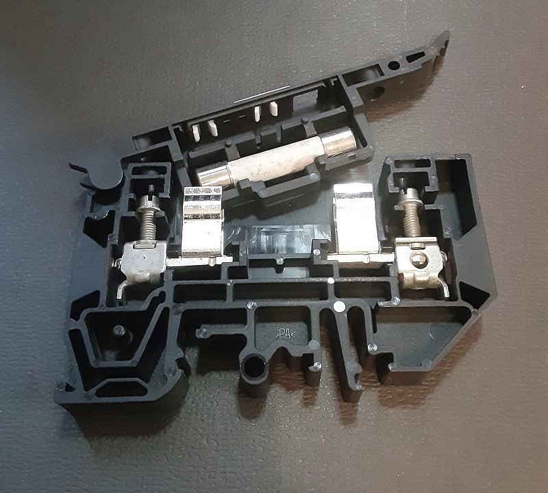

Industrial fuse inside a DIN rail holder
Figure 1. Industrial fuses are usually stored inside plastic holders mounted on cabinets or DIN rail strips. Image used courtesy of the Control Automation engineering team
Fuses come in all shapes and sizes, but industrial fuses are typically cylindrically shaped with a metal strip or a thin wire of a specific size, designed to melt when a rated current passes through the fuse. When the metal melts, the circuit is broken and no further electrical connection is made. Unlike resettable circuit breakers, once the fuse is blown, it can no longer be used and will need to be replaced with a new fuse of the same current rating.

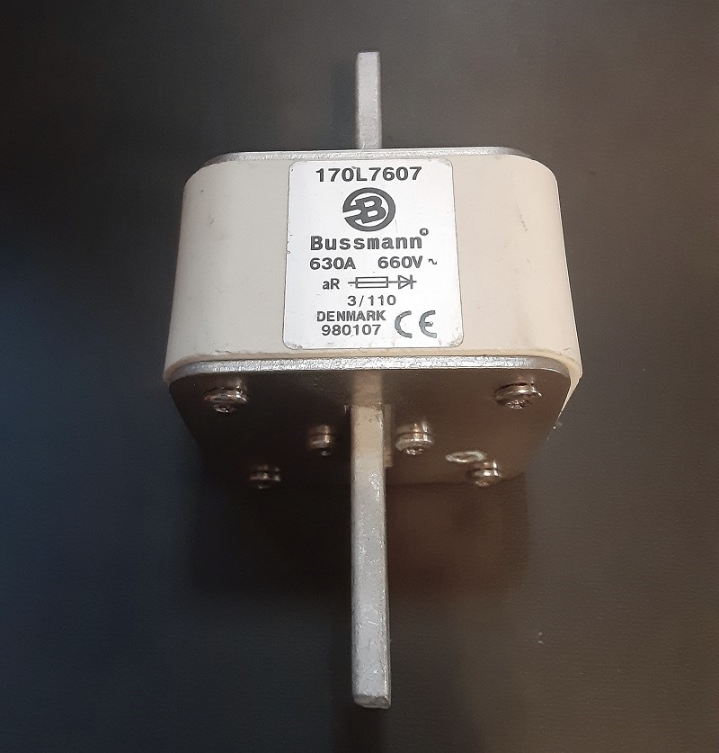

High-amp fuse with blade connectors
Figure 3. A large fuse with blade-style connections, this one is rated for 630 amps. Image used courtesy of the Control Automation engineering team

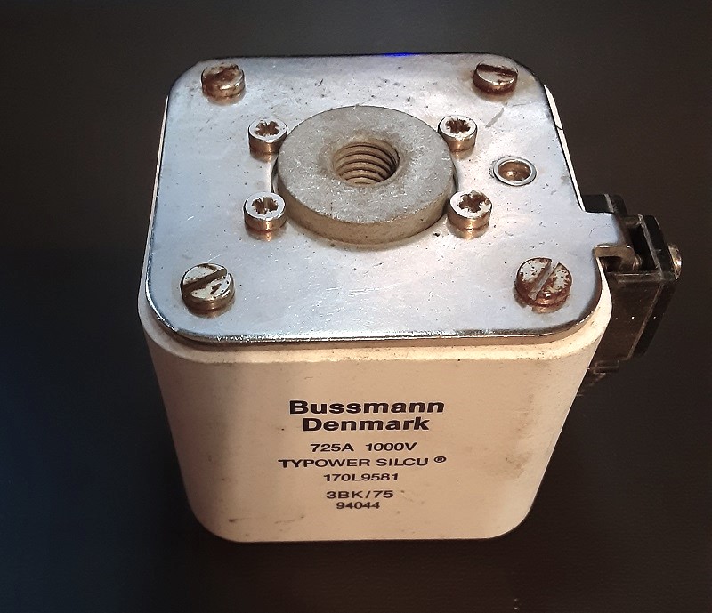

Threaded mounting fuse
Figure 4. A very large fuse (725 amp rating) with threaded posts for mounting. Image used courtesy of the Control Automation engineering team
