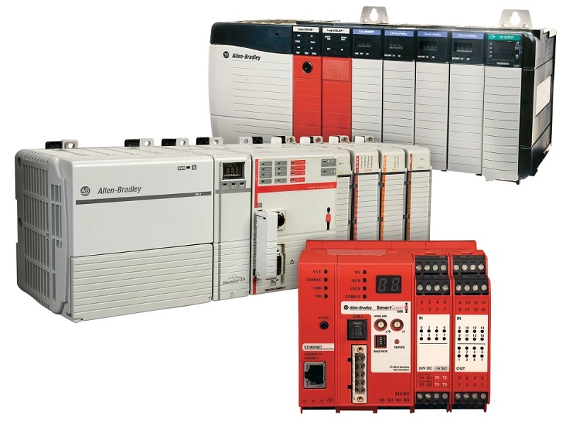

Various safety PLCs with standard I/O modules
Figure 1. Standard and safety PLCs look and operate in a similar manner, but safety PLCs contain more redundancy and safety-specific features, usually indicated with a bright color (red or yellow). Image used courtesy of Rockwell Automation
Safety PLCs can complete the same tasks and be used in the same ways as a traditional PLC but they have additional built in features that set them apart. They are built with redundancy in mind to help prevent failure. Since device failure and malfunctions are never 100% avoidable, safety PLCs have predictable failure modes that reduce the amount of disruption to the system in case of failure. Safety PLCs are also equipped with a safety circuit between the output and connected devices to ensure extra protection during a malfunction.

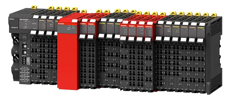

Safety rated PLC with some standard and some safety I/O
Figure 2. This safety PLC conforms to SIL 3 ratings and contains safety-rated programming object blocks that meet IEC 61131 standards. Image used courtesy of Omron

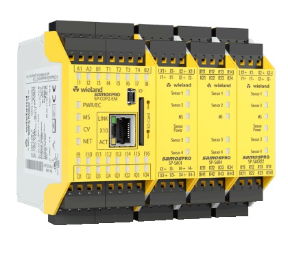

An example of a safety controller, but NOT a PLC
Figure 3. For simpler, less complex safety installations, a safety controller like this one may be a more cost-effective way to achieve proper safety controls for a cell. Image used courtesy of Wieland Safety
For simple safety tasks on small cells, the additional cost of a safety PLC may not make sense. For example, in a simple cell that includes a single light curtain and E-stop with no other safety infrastructure, the addition of a safety PLC will most likely cost more and add to the complexity of the system when compared to a safety relay or safety contactor. Each application should be carefully assessed before deciding between traditional safety and a safety PLC.
