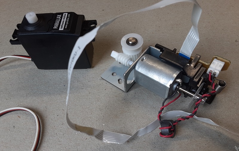

Small servo motors from an Arduino project and parinter
Figure 1. Two small servo motors, one hobby-grade (left) and the other (right) with similar components but using a rotary encoder built onto the integrated driver module. Image used courtesy of the author
A hobby-level servo motor is typically a 3-wire device supplied by a pulse train or a PWM signal from the microcontroller. This does not directly correlate to the 0-100% duty cycle of the signal, as if we were driving the motor speed, but rather it reflects a relative set point between a min/max range of speeds or fixed angular target positions.
Inside the motor, a small integrated circuit (IC) compares the incoming signal from the controller against the reference feedback device. For small servos, this is usually a small potentiometer that changes its output voltage as it is turned. The IC outputs voltage to a small standard DC motor, and as the motor turns, so does the potentiometer, creating an instant feedback loop. The IC can increase or decrease the output signal to the motor based on how closely it matches the target position.
If this strategy brings to mind the idea of PID loops, overshoot, and settling time, you are correct! This is one of the definite advantages (and complexities) of servo motors over standard motor drives.
In reality, hobby motors on an Arduino or R/C project probably don’t rely on PID loops, unless it’s a more advanced algorithm.
