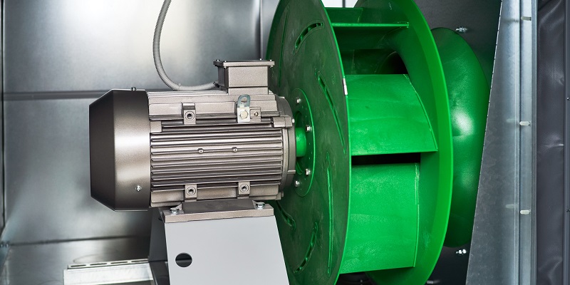

Large motor with a fam blade
Figure 3. Large compressors, pumps, and fans are some of the high-inertia devices that are well-served by softer start up cycles. Image used courtesy of Adobe Stock
Bypassing the soft start mechanism can be performed by switching to a separate set of contacts or autotransformer taps. There are also some solid-state and microcontroller solutions as well.
