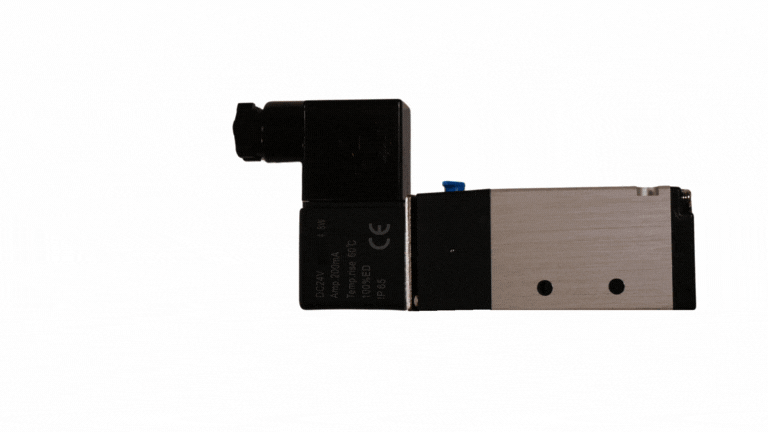

Spool valve assembly animation
Figure 1. Animation of a spool valve and the components contained inside.
Most spool valves use an input power of ether electricity (solenoid valves) or mechanical motion, like a lever arm or a joystick on an excavator. This part of the valve supplies the energy required to move the internal spool, in the case of above, it's a 24 VDC solenoid coil.
The next part is the actuator and relief valve assembly, which is present if the valve is driven by a solenoid coil. The coil itself doesn’t move, so the actuator is the ferrous metal component that pushes against a spring when the coil is energized.
The valve body contains the passageways for fluid inlet and outlet, usually machined from aluminum with threaded ports to accept connectors of many sizes. The valve body is specified by the terms ‘ports’ and ‘ways.’
Finally, inside the valve body is the spool itself.

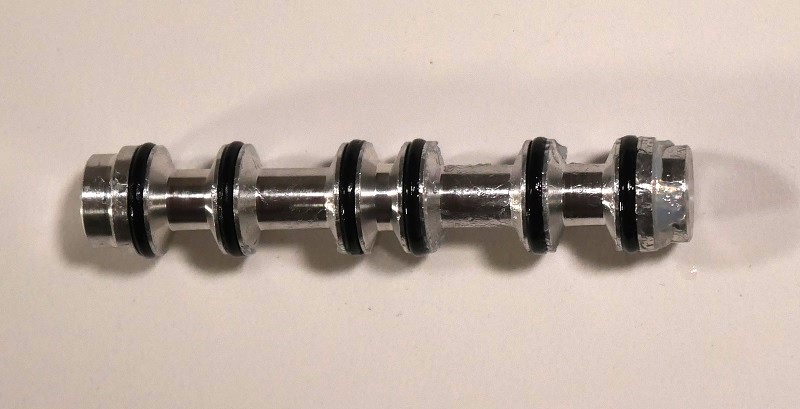

The valve spool mechanism
Figure 2. The valve spool mechanism is a machined shaft with grooves for o-rings. It must be greased well to maintain smooth motion.
The spool is a machined shaft with open spaces separated by lobes and o-ring seals to maintain an air-tight isolation between port openings. The spool only has two positions for most valves (2-way valves), but a sticker label on the side of the valve will show the connection between ports in both the energized and relaxed state.
There are many examples of 3-way valves, one relatable example being a common log-splitter, with positions to extend and retract the cylinder, and a central ‘neutral’ position that holds the cylinder steady.
If the valve is controlled by a solenoid, it is almost surely a 2-way valve with only energized and de-energized positions.

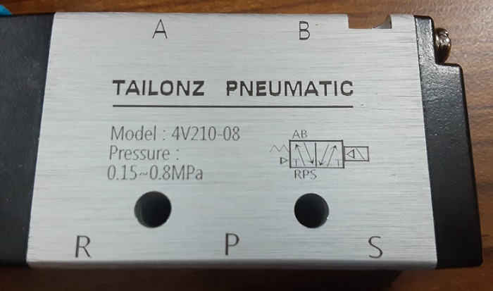

Spool valve symbol; spool valve electrical diagram symbol
Figure 3. The symbol for a spool valve. This one shows 2 positions with 5 ports: A, B, R, P, and S.
