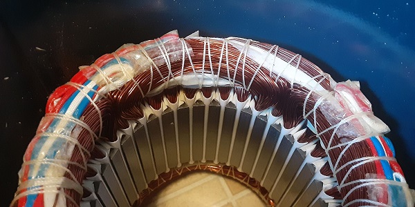

Internal windings of a 3-phase motor
Figure 1. The inside of a 3-phase motor showing the coils. Image used courtesy of the author

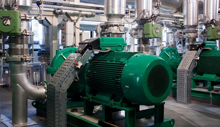

Large pump motors with integrated VFDs
Figure 3. This series of motors is used for variable-speed pumping, and each motor includes an integrated VFD mounted right onto the side of the motor. Image used courtesy of Adobe Stock

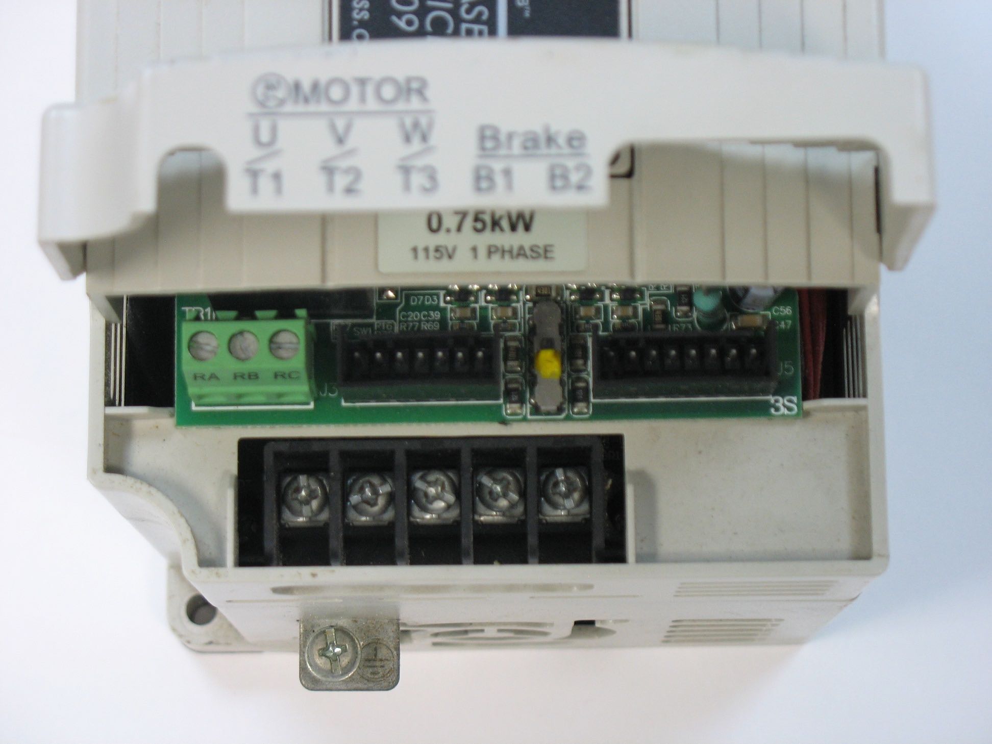

VFDs are rated most often by the voltage and by the power. Motor power in either HP or kW defines how much current and voltage together will be consumed at peak draw. The voltage of both the motor (VFD output) as well as the supply (VFD input) must be selected before purchasing. For nearly any motor over 1 HP (0.75 kW), both motor and supply will be 3-phase line voltage.
Close up of the power terminals on a VFD or inverter drive
Figure 4. This VFD shows a power rating of 0.75 kW (1 HP) using a single-phase voltage supply. Image used courtesy of the author
Be careful with voltage, because motors can be wired for either 230/240 or 480, and selecting the wrong motor with the wrong VFD output can permanently damage both devices.
