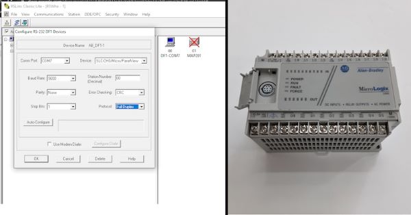

Baud rate on a PLC serial port
Figure 1. A common Allen Bradley MicroLogix 1000 uses a serial communication method, where the baud rate is selected in the RSLinx application.
Industrial equipment is a little bit different. It can be extremely costly, not to mention risky, to frequently upgrade computer systems. Most control systems contain tried-and-true communication protocols but also a bit behind the convenience of modern automatic configuration. I have often connected to a PLC and been prompted to provide information with terms such as “baud rate” or “half- and full-duplex” while manually selecting COM ports to route the information.

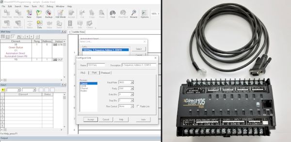

Serial COM port with baud rate selection
Figure 2. A DirectLogic 105 and its associated software, DirectSOFT, illustrating the selection of a baud rate for proper communication.
If the sending device is told to send data at a particular rate, but the receiving device only expects half of that data rate, it would miss every other bit. Needless to say, the data will be a complete jumble of useless information at the receiving end.
The baud rate usually appears as a pre-selectable list of data exchange rates so that a user cannot type in her or his own arbitrary baud rate. These baud rates usually range from a low of several hundred to a high of over 100,000 bits per second.

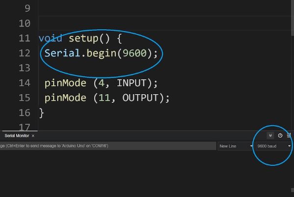

What does baud rate mean for a microcontroller?
 Figure 3. The Arduino programming interface, a common hobby microprocessor platform, where the baud rate is chosen for the controller board itself with a Serial.begin command (oval in upper left) and selected from a list at the PC terminal (circle in lower right).
  • Serial COM ports. Many micro-style PLCs using standard and proprietary COM ports will likely require information about a baud rate. I have configured many MicroLogix1000 processors which require such information. Fortunately, RSLinx is often able to auto-configure once the proper COM port is selected.

  • Microprocessors. I use hobby microcontroller platforms, such as an Arduino, on a regular basis. In this device, the baud rate is entered into the program and loaded onto the board itself; likewise, the same baud rate must be selected in the software.
