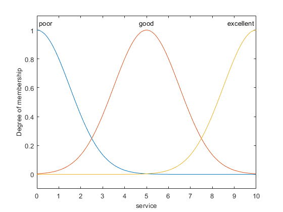

The fuzzification module receives system inputs in the form of crisp (as opposed to fuzzy) numerical values. The crisp value input signal is divided into a set of categories usually represented by linguistic values (e.g., cold, warm, hot).
Figure 1. A plot of three membership functions representing poor, good, and excellent. Image used courtesy of Mathworks
The fuzzy value for each category is the probability that the crisp value falls into it. Fuzzy values can also be thought of as a “degree of truth”: a car traveling at 95 mph could be “traveling fast with a degree of truth of 0.75.” The actual fuzzification process is accomplished by a set of membership functions, with the most common being triangular, trapezoid, Guassian, or Sigmoid.

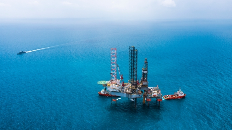

Figure 2. Fuzzy logic and neural networks can identify various regions in satellite imagery including offshore oil facilities.
Engineers use fuzzy logic as part of their decision-making support system, and it can be found integrated into marketing and advertising. In addition, fuzzy logic systems can be combined with neural networks as part of machine vision systems for identifying possibly differentiating between farmland, urban areas, forests, and water in satellite imagery.

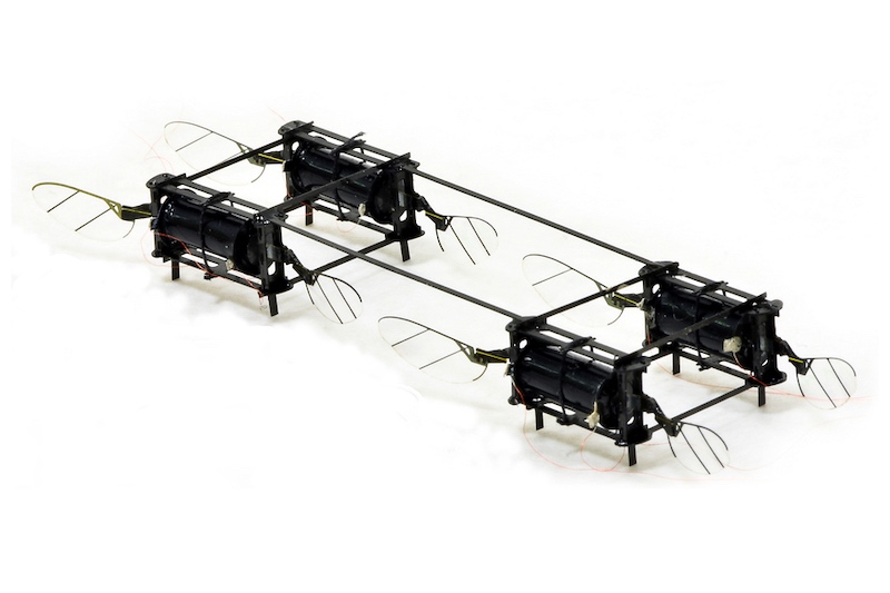

Pumps, motors, fans, and drivetrains can be controlled using fuzzy logic, receiving data from an array of sensors as input. Extremely precise motion control can be achieved utilizing FLCs, hence its use in computer numeric control (CNC) machining systems. Its ability to effectively control temperatures is evidenced by its use in kilns and heat treatment ovens that depend on highly precise temperature cycles. FLC can also supervise extremely complex system interactions, such as those seen in swarm robotics.
Figure 3. The technology behind developing swarm robotics systems, such as this one developed by MIT’s Research Laboratory of Electronics, leveraging the power of fuzzy control systems. Image used courtesy of MIT
