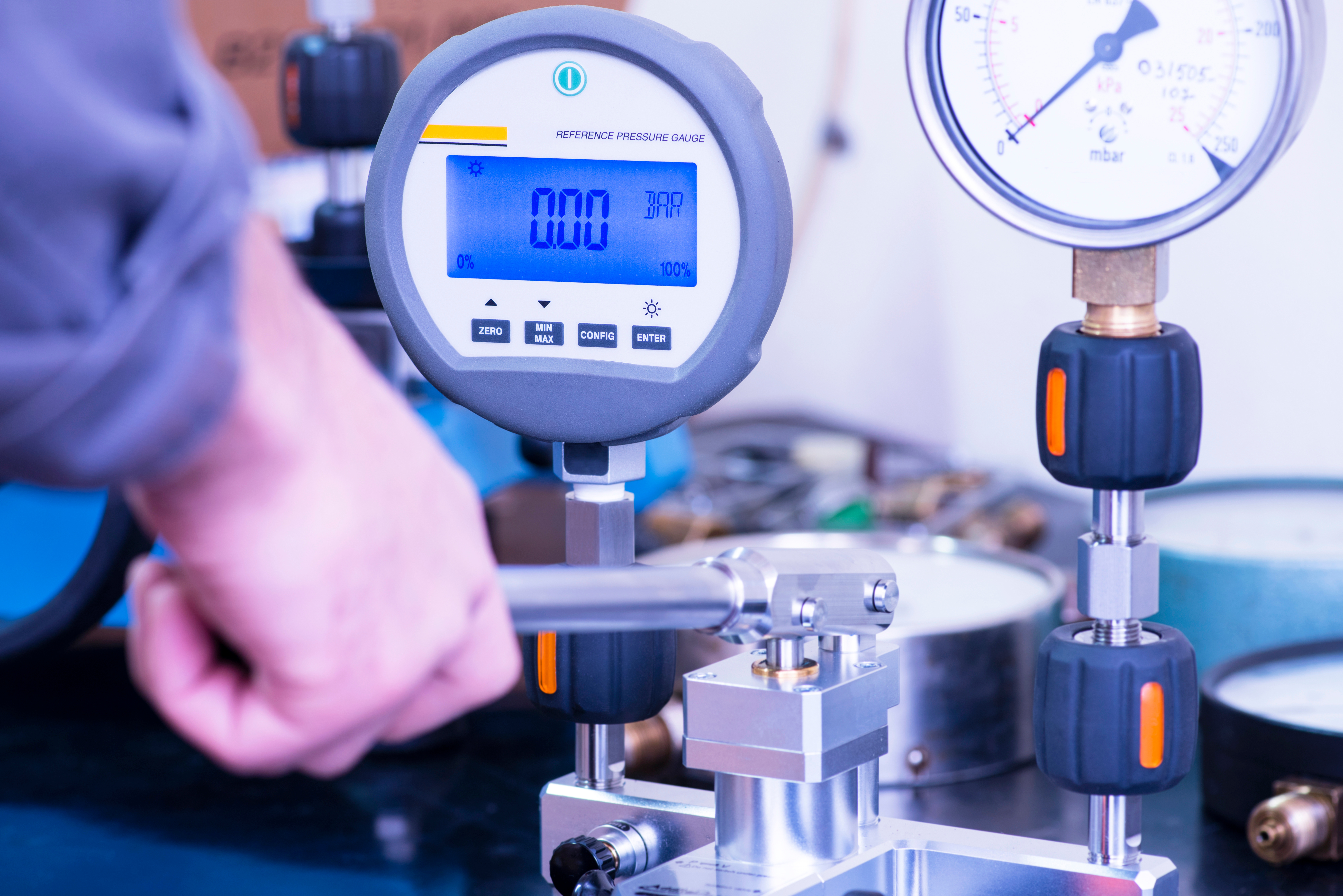

instrument calibration in industrial automation leads to high-accuracy signals result in higher-quality products, better customer satisfaction, and greater returns
Figure 1. High-accuracy signals result in higher quality products, better customer satisfaction, and ultimately, greater returns. Image used courtesy of Adobe Stock

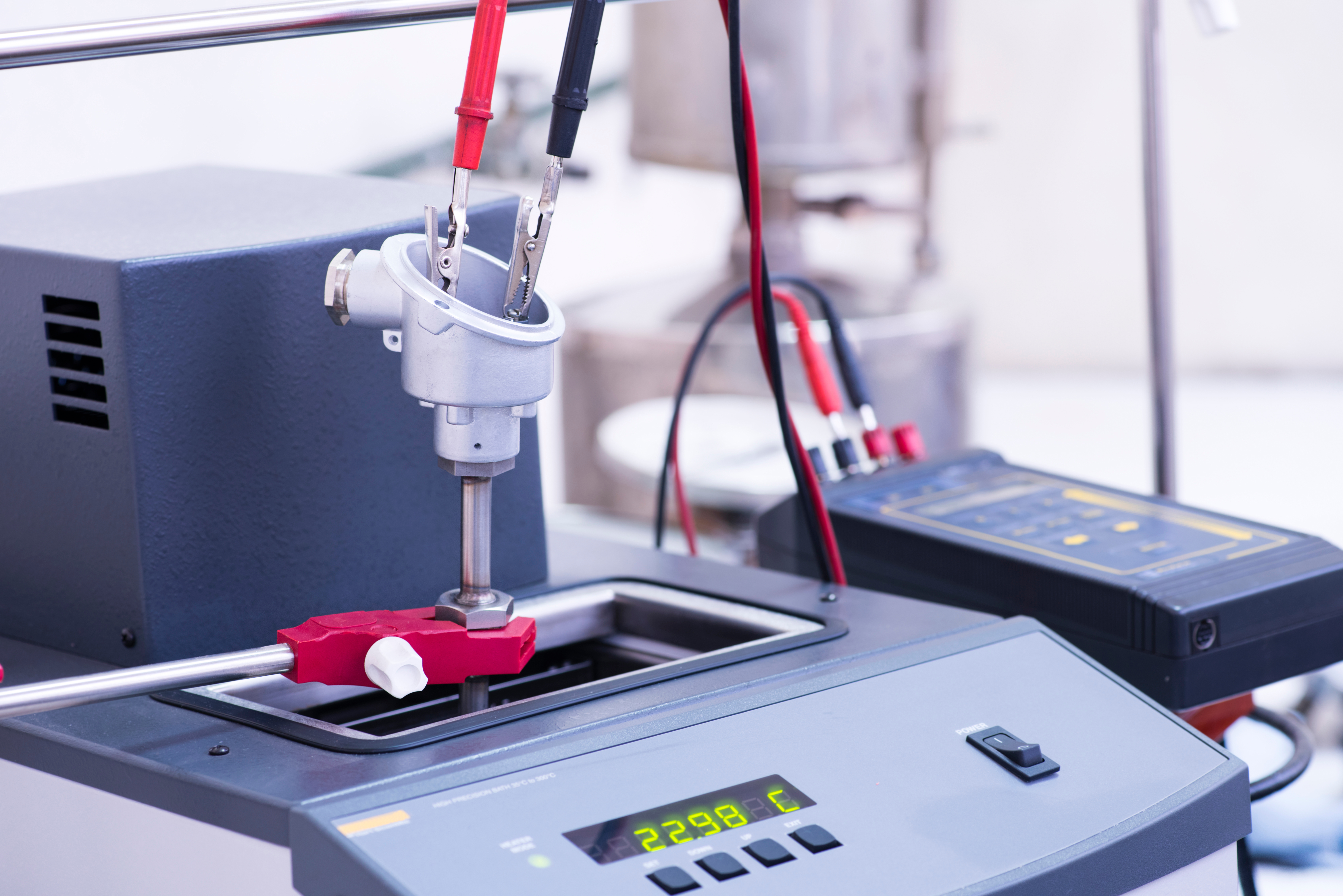

electrical device calibration, multimeter calibration
Figure 2.  Multimeter calibration as an example of calibrating an electrical device. Image used courtesy of Adobe Stock
Calibrating Electrical Devices
Electrical device calibration is used for instruments or devices that measure typical electrical quantity, such as current, voltage, resistance, inductance, and capacitance.
Some standard electrical devices that require calibration include digital and analog multimeters, oscilloscopes and scope meters, energy meters, RTD and thermocouple meters, and process instrumentation such as an RPM meter, data logger, and chart recorder.
How Does Electrical Device Calibration Work?
Electrical devices are calibrated by comparing their output with those of precise devices of known performance. These devices can generate measurement functions such as voltage, current, and resistance.
The traceable calibration tools will generate a wide range of the desired quantity, such as a voltage supply for meter testing, which might generate from fractions of a volt up to hundreds of volts.

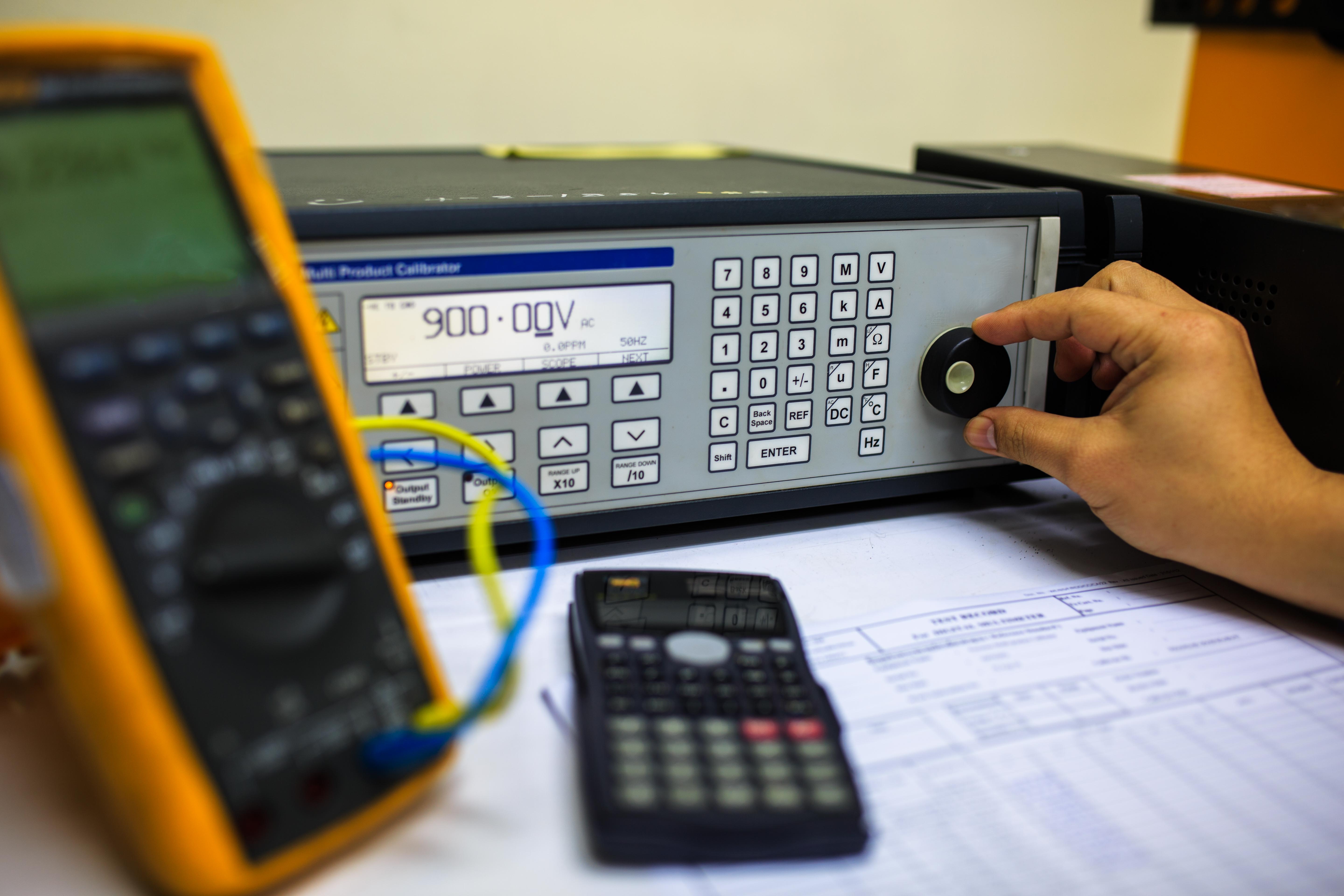

temperature calibration, temperature sensor calibration, thermocouple calibration
Figure 3. Thermocouple calibration to determine any deviation in the thermocouple output. Image used courtesy of Adobe Stock
Temperature Calibration
Temperature calibration refers to verifying temperature sensors (RTDs, thermocouples, thermistors, etc.). The calibration determines whether any deviation in the temperature sensor output lies within the acceptable limits.
How Does Temperature Sensor Calibration Work?
Temperature calibration is performed by simulating and comparing a known temperature value with the temperature device under test.
Commonly, there are two types of temperature calibrators: physical and electronic simulating.
Physically simulating tools include a very carefully controlled heat source, such as a hot bath, capable of creating the desired temperature. The temperature sensor under test is placed in this heat source, and its output is compared with the temperature of the heat source.
Electronic simulating tools are handheld devices that simulate the desired temperature value as an electrical signal, such as 4-20 mA or 0-10 V. This calibration might test the signal wires after the physical temperature has been converted to an industrial signal level.

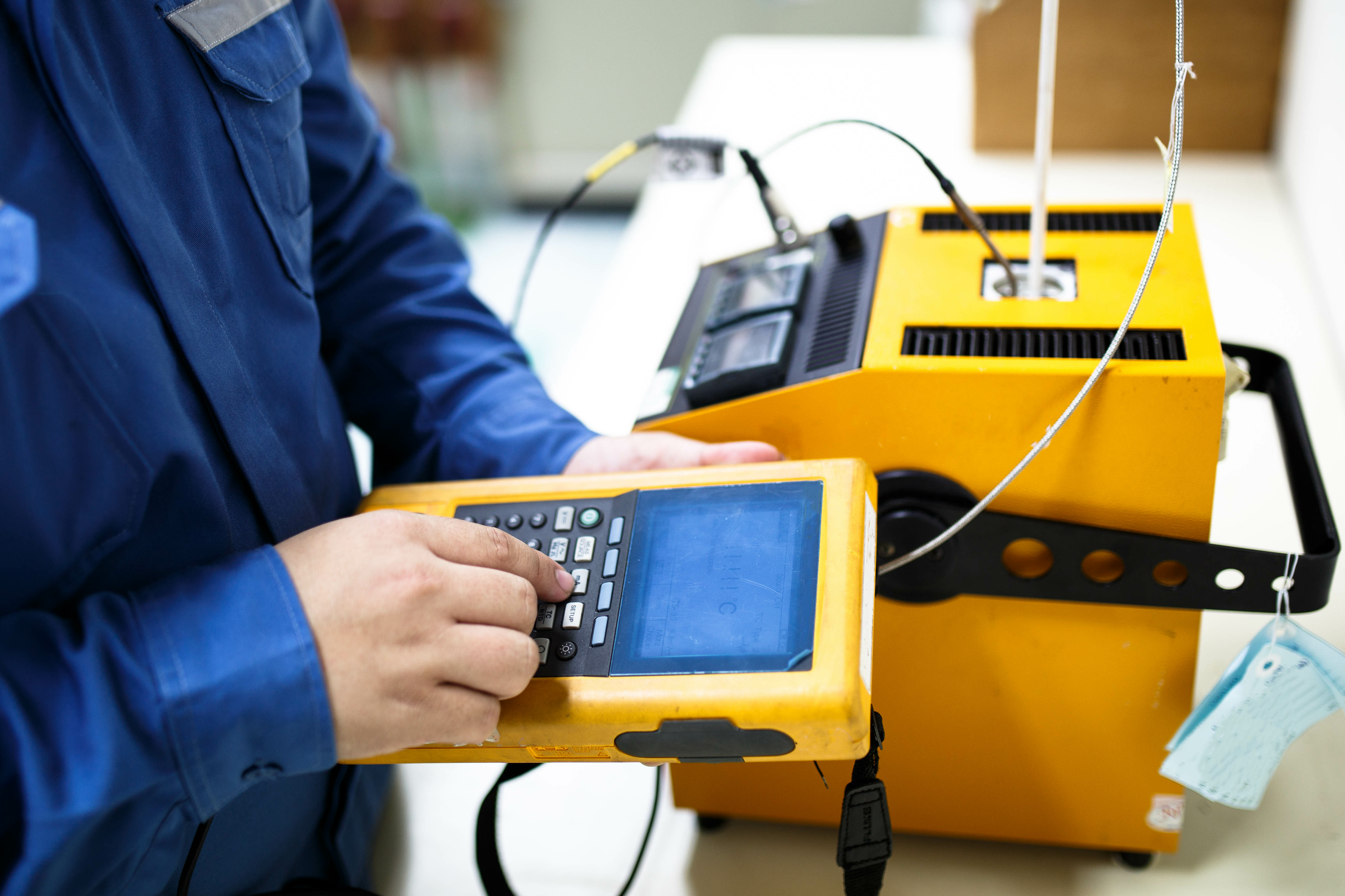

digital pressure gauge calibration, calibration of pressure devices
Figure 4. Pressure gauge calibration with portable pump. Image used courtesy of Adobe Stock
Pressure Calibration
Digital and analog pressure sensors can both be calibrated since the digital (discrete) pressure sensors switch on or off at very precise levels, while analog sensors output a current or voltage signal based on the fluid pressure. Based on the fluid medium (liquid or gas), there are many different kinds of pressure calibration tools.
How Does Pressure Device Calibration Work?
For pressure calibration, a portable pump is used to generate a known pressure. The pressure device under test is connected to the pump through appropriate connectors. The pump’s pressure is compared with the device's pressure under test.
Examples of pressure devices that can be calibrated include pressure gauges, digital indicators, pressure transmitters, and transducers.
