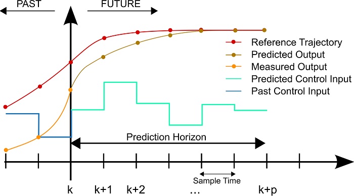

A basic working principle of MPC. Image courtesy of Martin Behrendt.
In order to understand the working of MPC consider the robot is at current time k in the simulated robot movement and has a reference trajectory that needs to be followed for a given horizon p.
MPC takes current states of the robot as input and simulates possibilities of control inputs for time k to k+p. From different possibilities, MPC selects the best series of inputs that minimize the cost function. From this series of predicted control input, MPC then implements only the first input and repeats the cycle at time k+1. Due to these iterative cycles over the horizon taking one step at a time, MPC is also called receding horizon control. This receding control can be better observed in the given simulation where black markers represent desired trajectories and red markers represent forecasted trajectories from MPC.

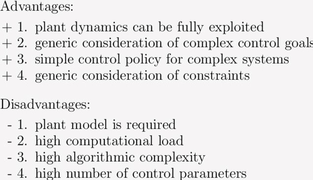

MPC has the biggest advantage of exploiting plant dynamics as it explores all or most available options of control input depending upon optimization algorithms. The second biggest advantage is its flexibility in achieving complex goals and implementing robust robot constraints. Depending on the requirement, there is a lot of room to curate task-specific objective function and apply design limit specific constraints on inputs, as well as predicted outputs of a robot. MPC, thus gives a very simple control strategy for complex control systems.
Along with its advantages, MPC has a list of disadvantages too. Depending on optimization algorithms and dynamic models of robots, MPC has a huge drawback of computational complexity because of iterative calculations at each time step. There are a lot of methods to reduce these computational complexities such as the following:
  1. Warm start i.e. using previous calculation as a base for optimization at the next step.
  2. Primal log barrier which reduces inequality constraints as a part of the objective function.
  3. Use of efficient optimization methods such as Newton’s method.
A diagram showing some of the advantages and disadvantages of MPC.
Secondly, a dynamic model of the robot is required for MPC which may not be very easy to derive for complex robots. Also, MPC has a drawback of having a high number of control variables.
