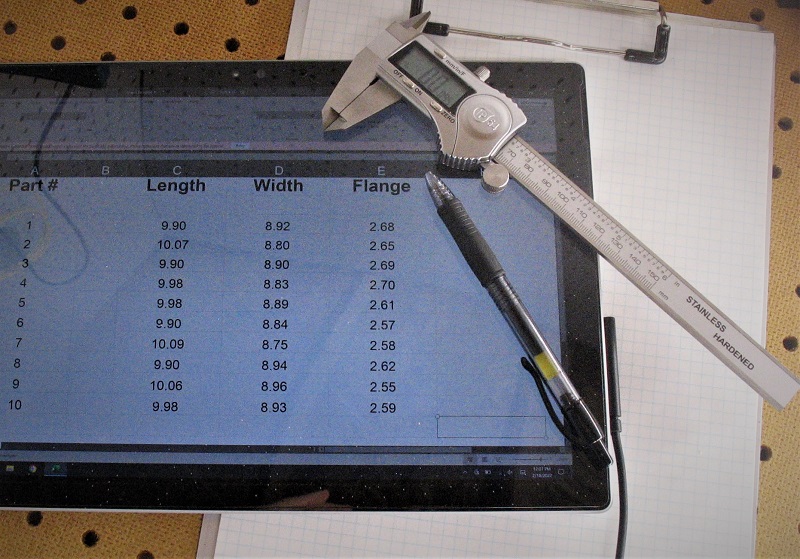

Data measurement and logging
Figure 1. SPC involves collecting and logging data, automatically in most cases, in order to make decisions.
Data Collection for SPC
Data collection encompasses everything from technician notes to measurements on products to process equipment parameters. Sensors and quality control measurements are used, but potential problems must be noticed before quality control catches the issue. Therefore, machine parameters, such as process pressures, temperatures, current, and vibration are tracked. This data may go unused until concerning trends or quality excursions occur. However, having the data available to help with troubleshooting is much better than making decisions on limited data, often leading to incorrect assumptions.

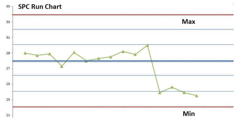

In general, SPC charts are organized by time on the x-axis and measurement on the y-axis. Called a “run chart”, this organization scheme shows how some aspect of the process has been performing historically. Each data point may represent an individual measurement or an average of measurements. Ideally, this chart would be a horizontal line, meaning a parameter has not changed throughout history, and the process is completely predictable and repeatable. However, reality shows us that this is never the case. Instead, the process varies slightly requiring limits for how much variation is to be tolerated.
Run chart applied to vehicle mileage
Figure 2. A run chart, plotting the miles per gallon (MPG) in the author’s car. The big step change could be due to an oxygen sensor failing, a change in driving habits, or another issue requiring investigation.
Besides the run charts, there are also “sigma” charts. The sigma charts show time on the x-axis and the standard deviation from the mean on the y-axis. Ideally, these charts would be a horizontal line at “0”, meaning there was no variation, but once again, there will always be some variation in every real process. Sigma charts are often viewed at the same time as run charts, because a quality excursion may not be evident on the run chart.
Control limits are specified on both types of charts. The control limits are governed by rules established by the engineers to alert them of potential problems. It could be that the control limits on a sigma chart are simply +/- 3 sigma away from the mean, indicating a defective product. To truly benefit from SPC, more rules are required so that actions are taken earlier and no defective products are manufactured.

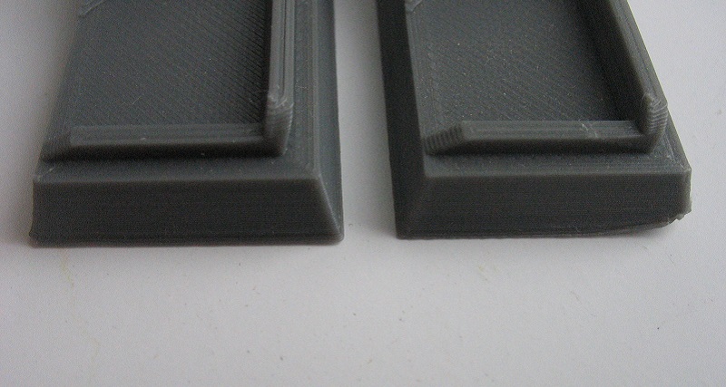

Besides minor process changes, major process changes rely on well-designed test experiments. Experiments must be designed carefully to ensure that the data collected is accurate and models the end result of the process.
Quality variations in a process
Figure 3. Even a small process change (in this case, only 2 degrees F) can result in major quality impacts between parts. All experimental changes should be carefully controlled and documented.
DoE is as much an art as it is a science. In general, experiments must be screened to determine valid process parameters, experiment order randomized and checked. Furthermore, results should be checked using more advanced statistical methods to ensure that the process change is statistically significant. Finally, accounting or financial personnel should be consulted to ensure that the change is financially sound.
